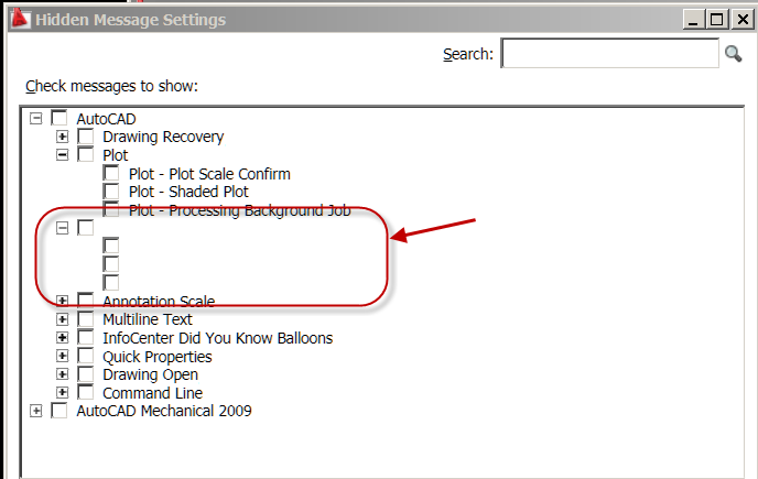

If you type OPTIONS at the commandline; then navigate to the tab called System. On the right hand side of that, you will see a button called "Hidden Message Settings". Click that, then navigate around the collapsable/expandable tree to your desired area(s).

Talk about hidden messsages! :shock:
