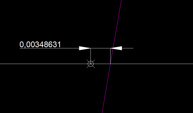

(setq pt1 (vlax-curve-getclosestpointto obj pt1))
As sometimes the pick point is like 0.0000001 different, even with osnap on.

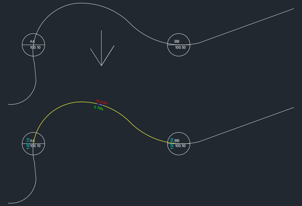

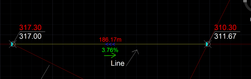

Sometimes objects(BLOCK,POINT,COGO POINT) do not coincide with the end points of the line. How can LISP do this? please see example dwg rev4 file in attached.
image.png.ae2d54a8b277fff21e13739c88922e1a.pngimage.thumb.png.bb6154f270a2068b0b1e72981fced7d0.pngimage.thumb.png.a1eb3b4e4ce7f2ec9eeddc86b55b8e73.png
HotOffTheGrill _ rev4.dwgFetching info...
Edited by macros55

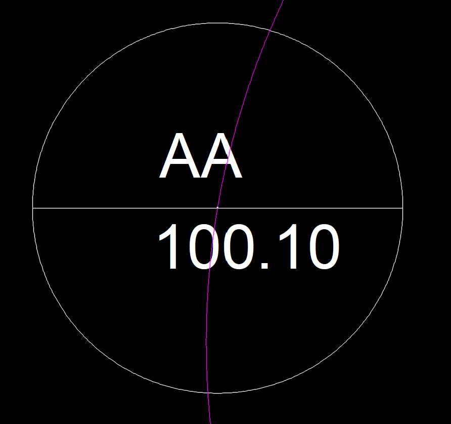

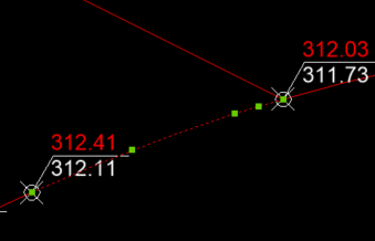

Mr @Tsuky, Is it possible to adjust the touching distance of the object? If the object does not touch the line within 0.0000mm, the process does not occur. I think it would be better if the object's even touching distance was set to 0.05m.
image.thumb.png.30d10a6b7d7b5949e3990ec753bda5f1.pngimage.thumb.png.bc29baa0f3579cc2a45eef43cb511643.png
Edited by macros55

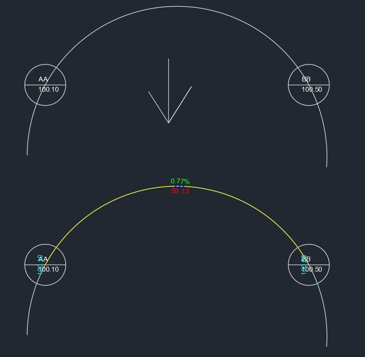

Sir . I updated it, the 0.05m edge capture mode worked, but I think there is a few missing. It does not create a yellow Polyline with the Block on the polyline. When only ARC is selected, it creates a yellow ARC. Also, The lisp it doesn't recognize it only when it's Line.
There is a problem with the arrow of the slopes because the arrow always points in the same direction, also the objects show different values depending on the first and second selection -1.55% /+ 1.55%. Would changing the arrow drawing to text <<</>>> be a solution?

Because you want a yellow pline section working with curves in a pline it is difficult, a quick workaround is copy the pline say to right 200 then adjust the 2 points chosen points X+200, trim the pline both ends, change its layer so becomes yellow, move it back -200, all done. Removes all the headaches of trimming and remaking plines.
No Code at this stage just a suggestion. Image shows idea.

Unfortunately, it did not recognize some lines.
Also, when the object selection changes its location, the direction changes, but the direction  should follow the slope and always take the direction >>> towards the lower elevation.

I think I have resolved your wishes.
However, I noticed for example that for a polyline with overlapping vertex, the new entity is not created.
Use OVERKILL on any that might cause problems.

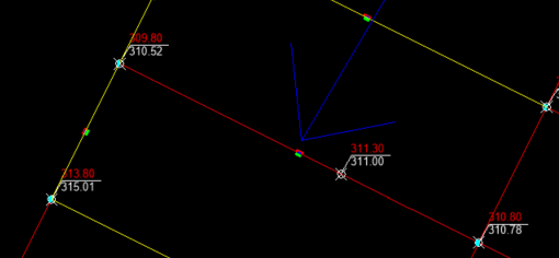

I can see now why the approach of looking at pline bulges etc.
There is no point at the 311.3/311.0 so the slope is incorrect just a comment. May be others.

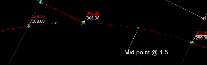

A better approach to DO ALL may be to just walk along the line/pline and find vertices then look at the blocks at ends of each segment. There is a function that when getting a param at a pt if you use like 1, 2 etc its segments but 1.5, 2.5 etc  is the mid point of a segment. This is in some code I was looking at yesterday and solution by Kent Cooper over at forums/autodesk from a few years back.
I need to throw away what I did and have another think about it. I would use the segment idea and 0.5 steps. No need to work out bulges etc.

Oh yeah do we really need the Yellow's or is that just for checking ?
Another problem but the 2 arcs are same radius. So extend 1st arc.

Mr. Bigal, I tried the code you wrote, unfortunately I couldn't get the result. I shared a video and picture attached. The LISP prepared by Mr. Tsuky works exactly as I want, LISP is doing the right thing. Even though there is another block in the middle, it only adds the yellow Polyline between the two selected blocks.
But it does not do the adding a yellow polyline in some places. It would be great if adding a yellow polyline solves the problem.
And when you select "Line", sometimes the slope arrow goes in the opposite direction, up to the elevation side, but the correct arrow should be down to the elevation side.
