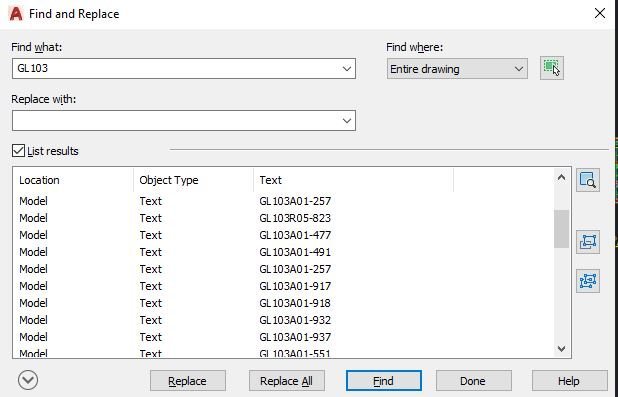

I do a search (FIND) for a text string in my .dwg and get a list, the main problem is that AutoCAD won't let me COPY out the results from my search...
I'd like to copy the hits from this list into a .txt or .xls file but CTRL+C won't work and there's no right-click options
Is there a lisp program available or other options to get the results in a table or Excel ?

Using ssget filters can be done. This will make a selection set which can then become a CSV or direct to Excel.
(setq str (strcat (getstring "\Enter string prefix") "*"))
(setq ss (ssget "X" '((0 . "TEXT")(cons 1 str))))
@BIGAL Thank you, I do not know lisp that much, do you have a complete lisp to do that. Maybe something like after pressing DONE will transfer the results to the clipboard or Excel
Do you want 1 string search to excel or is it do repeated searches. Please confirm.
