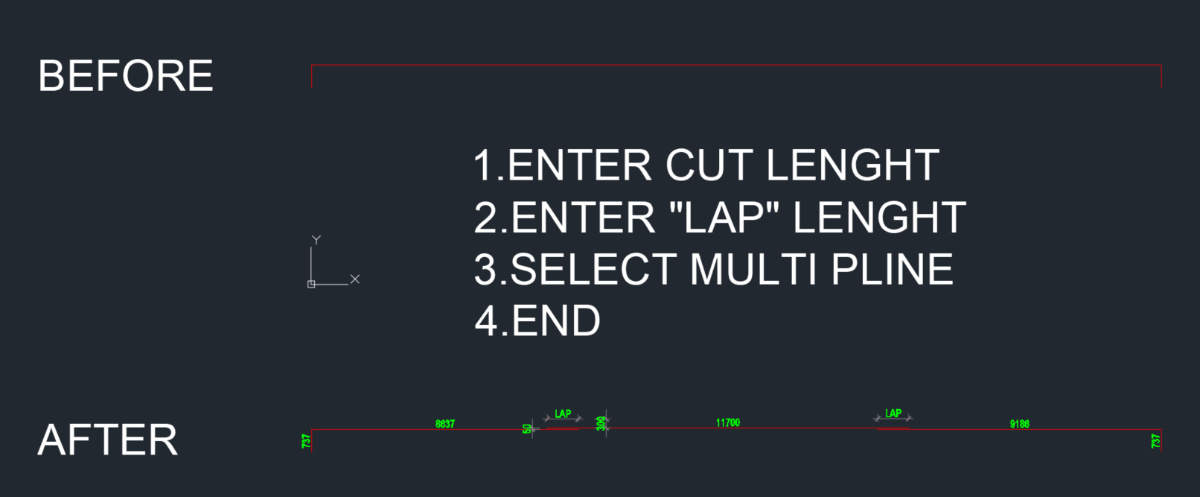

Hi everyone, please help me lisp cut pline, please see the uploaded file. Thank so much.

If its steel reinforcement are you sure you can get > 11700 lengths ? say a 12m long bar ? Been a while since I did steel reo.
18 hours ago, devitg said:
@vandehuy how to know distances between lap. ?
sorry do you mean cut lenght?
@vandehuy yes how you state the 8637 ,  11700 , and so on. ?
Sir I already have a pline cutting lisp, can you help me complete the dim pline based on this lisp

This can be a start ?

Am I missing something? Is it not pick a start and end point, then draw the bars with overlap and a max length of 11700. Include dims etc.
You can just select a line...
Without specifying points...
