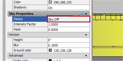

I have no idea what to do next. I cannot set the sky with illumination. In fact I can't turn the sky on at all. I have checked and LIGHTINGUNITS are on, that is I've tried 1 and 2, even setting it to 0 to see if that would kickstart something then back to 1 and 2. But no matter what I try, the Sky Properties Status continues to show off and it's shaded and I cannot even open up the choices for it.
Can anyone tell me why AutoCAD 2009 would be doing this?
did you turn on your sun first? and did you turn off the default lighting?
Yes, the sun is switch on and the default lighting is turned off. I've read the docs until my eyes hurt and cannot seem to find what's up with this. The sun choices will not even open up so some variable somewhere has to be holdimg this thing hostage.
ahhh ive had this problem too, try and change the view to perspective that worked for me
Perspective view resolved the issue. But the sky in the renderings is just a dull grey color. I don't know it that's the graphic card limitation or if using a background would improve the asthetics. What's a real ***** about this is no where in the AutoCAD Help menu does it mention that Perspective must be turned on before the Sky will work.
