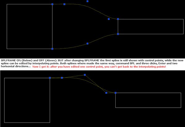

Raggi_Thor Posted November 2, 2007 Posted November 2, 2007 How do you use to use these curve generally?I feel, as I study it, I cannt control it . I can modify its control point, but how to adjust knots positon? In my Acad 2008 the interpolating points are there and can be stretched (moved), but they dissapear after I change SPLFRAME to 1 (ON) and modify a controlpoint. Quote

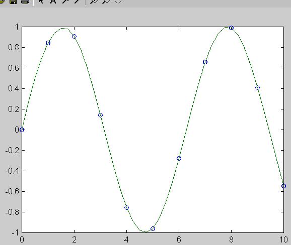

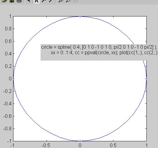

cnreader Posted December 19, 2007 Author Posted December 19, 2007 These are drawed by another software. one is cycle and another si sine wave. drawed by b-spline. Quote
