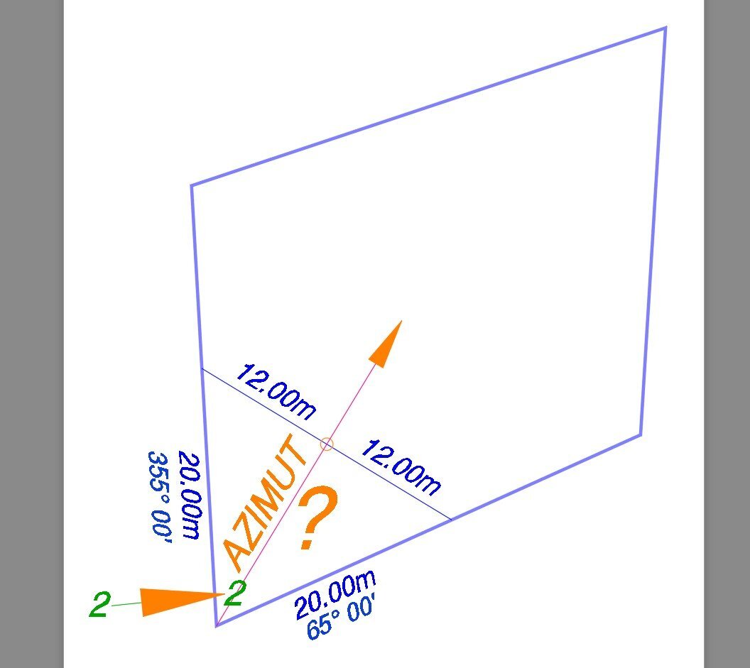

duke Posted May 4, 2024 Posted May 4, 2024 Hello again friends ‼‼ I attach an explanatory image. I would like to place a text (a green number 2 in the image) at a certain distance from the vertex of the Poly. If the Azimuth of both lines are known, through a Routine, how do I find out the Average Azimuth of those 2 Lines, to be able to position the green text 2 at a certain distance from the vertex Thanks in advance friends ‼‼‼‼ Quote
tombu Posted May 4, 2024 Posted May 4, 2024 Easiest to code would include picking the vertex and the two endpoints. For bisecting using lines and polylines see: http://www.cadtutor.net/forum/showthread.php?100709-Draw-bisector-line&p=684958&viewfull=1#post684958 1 Quote

BIGAL Posted May 6, 2024 Posted May 6, 2024 Try this ; Put number at 1/2 internal angle ; By AlanH May 2024 (defun c:labmid ( / oldsnap dist p1 p2 p3 p4 ang1 ang2 ang3) (setq x 1) ;; Get Inside Angle - Lee Mac ;; Returns the smaller angle subtended by three points with vertex at p2 (defun LM:GetInsideAngle ( p1 p2 p3 ) ( (lambda ( a ) (min a (- (+ pi pi) a))) (rem (+ pi pi (- (angle p2 p1) (angle p2 p3))) (+ pi pi)) ) ) ; clockwise check by G Carlo (defun gc:clockwise-p ( p1 p2 p3 ) (< (sin (- (angle p1 p3) (angle p1 p2))) -1e-14)) (setq oldsnap (getvar 'osmode)) (setq dist (getreal "\nEnter radial distance from corner ")) (setvar 'osmode 35) (while (setq p1 (getpoint "\nPick 1st point away from intersection Enter to exit ")) (setvar 'osmode 32) (setq p2 (getpoint "\nPick point at intersection ")) (setvar 'osmode 35) (setq p3 (getpoint "\nPick 3rd point away from intersection ")) (setq ang3 (/ (LM:GetInsideAngle p1 p2 p3 ) 2.0)) (setq ang1 (angle p1 p2)) (if (gc:clockwise-p p1 p2 p3 ) (setq p4 (polar p2 (+ ang1 ang3 pi) dist)) (setq p4 (polar p2 (- ang1 ang3 pi) dist)) ) (setvar 'osmode 0) (command "text" p4 1.0 0.0 (rtos X 2 0)) (setq x (1+ x)) (setvar 'osmode 35) ) (setvar 'osmode oldsnap) (princ) ) (c:labmid) 1 Quote
