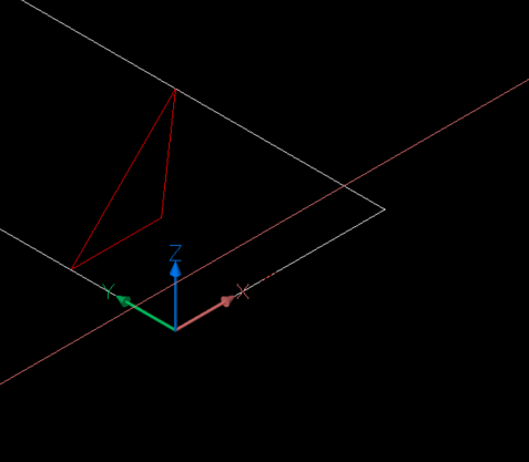

1st step is get a copy of Text2GEOM by ASMI, it explodes text and attempts to make plines of the text, yes still need to clean up letters. But no way takes an hour. I am no expert on 3D solids so I am sure others will provide some answers. Have you tried using extrude path. One suggestion is scale the text 1/2 width makes the triangle easier to workout. Used rotate3D to stand up.
image.png.7784f0c8e1619036045ac61e7375e878.pngText 2 geom.zip
