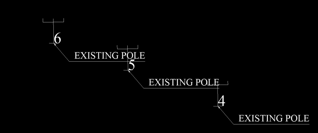

Hi anybody can help
i have many multiple text and those text to be combine with leader for combining text and leader i use lsp but lisp only work when text and leader are in same point, one more scenario is after joining leader and text those also fall near by location of block insert point but i want leader head to be insert with block for more i was givin dwg file
Drawing3.dwg
Edited by pmadhwal7
Just a question why are they wrong ? Going back a step how is leader made & how is text made. Does not make much sense that its being done incorrectly.  Sounds like its sloppy drafting.

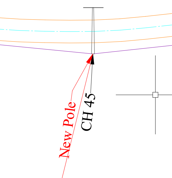

actually those text are placed from excel sheet, firstly i was export those pole coordinate to excel and when i got coordinate of pole i just serialized them and paste their type from other excel to exported excel leader comes from another dwg and placed as per block location then paste text from excel sheet and join both
You can create a text object with one command. If you want a multiline text, you have to do some work, but you get more control.
Look into the DXF codes. You can create a multitext with the entmake command using a list of these codes in this order:

Ok sounds like you need to go back to the Excel data insert the pole block, pause for leader direction then go to next row. If you Auto insert and make a leader the direction will be fixed which may be ok.
Post EXCEL.
Post EXCEL.
Dwg and excel are attached
Pole.dwg Pole.xlsx
Ok no probs insert pole and Number. Then do a leader with fixed offsets for moment. Just read the XLS values.
Give this a try. 1st thing is made a new dwg called poles which has the pole blocks in it, if you use a template with those blocks will still work. Edit the location of POLE.DWG so missing blocks are found.
Just open the correct excel file before running.

hi CyberAngel how to use this?
Entity Type - (0 . "MTEXT")
Object Type - (100 . "AcDbEntity")
Layer - (8 . <layer name>)
Object Subtype - (100 . "AcDbMText")
Location - (10 . <point>)
Direction of UCS - (11 . (getvar 'ucsxdir))
Translation Matrix - (210 . '(0 0 1) 1 0 T)
Text Height - (40 . <height>)
Justification - (71 . <insertion point, see below>)
Contents - (1 . <text>)
Style - (7 . <style>)
Rotation - (50 . <angle in radians>)
Fill - (90 . <code, see below>)
Background Color (pick one) - (63 . <color index>) / (420-429 . <RGB color>) / (430 . <color name>)
Fill Box Scale (optional) - (45 . <margin>)
Transparency - (441 . 0)
Some notes:
The Justification value is an integer: 1=top left, 2=top center, 3=top right, 4=middle left, etc.
You can omit the Style code, it will default to Standard.
The Fill code is the sum of these integers: 0=none, 1=background, 2=drawing window color.
For the multileader options, here's another set of codes. I haven't had time to figure out exactly how these work.
I know, it's a lot of information. If you have questions, post a response.
Here's what I did. You may have to adjust the code for your situation, especially if you're creating a multileader.
First, create a prefix and a suffix for the main command string. These items won't change from one instance to the next.
(setq lbprefix (list
    '(0 . "MTEXT") '(100 . "AcDbEntity") (cons 8 (getvar "clayer")) '(100 . "AcDbMText") ))
  (setq lbsuffix (list
    (cons 7 (getvar "textstyle")) '(50 . 0) '(90 . 3) '(63 . 256) '(45 . 1.1) '(441 . 0) ))
Get data from user: pt3, for instance, is the multitext insertion point and ptjustify is the justification code (described above). Do your calculations. Then put it all together.
  (entmake (append
    lbprefix
    (list
      (cons 10 (trans pt3 1 0))   ; location (in current UCS)
      (cons 11 (getvar 'ucsxdir))
      (cons 210 (trans '(0 0 1) 1 0 t))
      (cons 40 lbheight) ; height
      (cons 71 (atoi ptjustify)) ; justification
      (cons 1 lbtxt) ; contents
    lbsuffix
  )) ; end append/entmake
You're constructing a list of dotted pairs and passing it to entmake. It only looks complicated because there are 16 pairs and I split them into three lists.
Tack this onto the code BigAl provided, and you should be well on your way.
Edited by CyberAngel
changed a word
