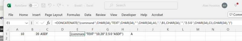

BIGAL Posted April 28 Share Posted April 28 (edited) Like devitg post XLS, yes can read Excel direct. Only question is there always a header line ? Â You could do it in Excel using a Concatenate command just copy in example column E to Autocad command line. Â Â =CONCATENATE("(command ",CHAR(34),"TEXT",CHAR(34)," ",CHAR(34),A1,",",B1,CHAR(34)," ","2.5 0 ",CHAR(34),C1,CHAR(34),")") Â Edited April 28 by BIGAL 1 Quote Link to comment Share on other sites More sharing options...
Jonathan Handojo Posted April 29 Share Posted April 29 If all you're after is importing the text, then I'd go with what @BIGALÂ suggested. By forming some formulae, you can create the necessary strings that you can simply just paste into the command line: Â Â 30000 is just an example text height that's set, and 0.0 is the rotation angle. 1 Quote Link to comment Share on other sites More sharing options...
