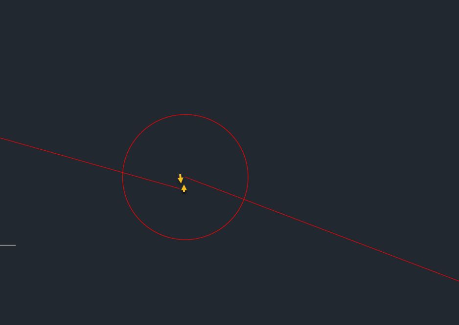

samifox Posted April 19, 2024 Posted April 19, 2024 hi i need a lisp to snap vertices onto each other. if you have a long line that consist of lots of segment and not all segments are perfectly snapped to each other ased on proximity and distance. there must be a lisp someone wrote for this. any idea? Quote

samifox Posted April 20, 2024 Author Posted April 20, 2024 I've adjusted the FZ to 3 and ensured that the lines aren't spaced more than that. However, it didn't yield the desired outcome. Additionally, even if it does work, shouldn't it align ? not just select??" Quote

Jonathan Handojo Posted April 21, 2024 Posted April 21, 2024 (edited) I do have something. However, this doesn't technically "move" the line, it simply extends and trims the line to meet at the intersections. Just don't enter a tolerance too big. After you run this command, then you can join them (or even confirm using the forementioned Chain Selection program by Lee-Mac. In the attached I tried NEATX for fun, but the result turned out ugly as hell. So I just recommend NEAT instead and then you specify the tolerance... of probably 5 to 10, if your objects aren't too far. I can't really guarantee that this will work to your expectation, but hopefully it should. Neaten.lsp Edited April 21, 2024 by Jonathan Handojo Quote
