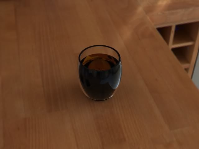

MikeScott Posted March 28, 2010 Posted March 28, 2010 It looks great, but that's just a background, isn't it? I'm referring to a new, non-existing room, with specific lighting set-ups.. like as in like a kitchen 3d rendering, where you define wall positions/ surfaces, etc. Or like a building as seen from the air or something. I was under the impression that AutoCAD does a better job at that sort of thing. Quote
shift1313 Posted March 29, 2010 Posted March 29, 2010 Well solidworks has a few ways of defining an environment. The scene you see here is comprised of 4 walls, floor and ceiling all linked(even though you dont see all of them). The way the images on the walls are mapped can be defined a few ways but the images on these can be whatever you choose. The one above is one already in SW. This one here is a glass i drew and used the Kitchen scene in SW. there isnt a counter there only the model/image relationship makes it look that way. If you are modeling rooms, buildings or whatever this is fine as well. You can model whatever you like, place cameras(great control over cameras by the way), add your own lights and so on. The quality of renders is only going to be what you make it. I prefer the solidworks environment but it is what it is. The software is designed as a mechanical cad system as well as surfacing, CAE and so on. Something like Acad Architecture is a program suited for architecture with built in tools just for that industry. If your are only planning on drawing buildings or something like that, most of the features in SW will probably be lost because they are tailored towards another aspect of the industry(not saying that you cant use it). Just like Autodesk has dozens of products that are geared towards different aspects. A program like Alias Studio is for complex surfacing and you can then take those surfaces into Inventor to say create some of the structural aspects of the design as well as analyze it for strength, moldability and so on. You can draw complex surfaces in inventor, but Alias gives you more control options. I hope that made sense. Quote
