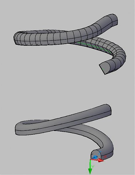

I need to draw a tunnel that rides along an helix-like path.
- Using 'sweep' creates a constantly twisting section, but in the reality the bottom of the tunnel (called invert also), must be horizontal (with a slight inclination for water drainage).
- Using loft doesn't function.
- Using extrude ends in a sweep command, with equal results as before.
Any ideas?

your "tunnels" arent valid(they are regions) for a loft and your path isnt valid either. I moved your model to the origin first. then i did UCS>OB and selected the first cross section. this aligned the xy plane with the object, i then exploded your region and used the PEDIT command>Multiple>Join and make your cross sections polylines. Your last section isnt closed and needs to be, also a few of your cross sections have copies underneath themselves. After i moved the UCS to each cross section, exploded and PEDIT i then redrew your path using a SPLINE. you can do a loft without using the path but it wont give you exactly what you want(but close).

After I exploded all your cross sections and began trying loft it gave me an error. I then tried the loft one section at a time until i got all the way to the end and realized the last one was giving me the error. When you click on the profile you can sometimes see the blue snap points dont meet in one corner. I just used PEDIT>Close to take care of it. I think there is a command but i dont recall what it is because ive never used it(but have seen it on here) I used the PEDIT>Close on all cross sections. Im guessing you drew one then copies it around to the other positions? If i had to guess id say your bottom right corner points arent touching.

It needs to be converted to a polyline. If you select it and right click>properties it will tell you what the selected object is. If you type PEDIT, select your line then Spline curve it will convert it BUT it will change the curve slightly. It worked as a Path for me only using the first and last cross section but it wouldnt let me use it for all the cross sections so i'd have to play with it a bit more. My guess is that it doesnt hit the midpoint of all your cross sections and this is making it invalid as a path.

I played with it a little more. For some reason it doesnt like your second cross section(from the top of the tunnel). After I converted all your cross sections to polylines, and converted the path to a spline curve, i deleted the second cross section and copied the first one over to its location and it seemed to work fine. Here is a copy of the file. Because of size limitation its only the path and your guides. You can loft through them selecting your cross sections in order then P for path and select your green line. Let me know if this does not work

I followed your instructions and worked perfectly. I also checked your dwg and everything is ok.
Thanks a lot, you saved me a lot of time.
