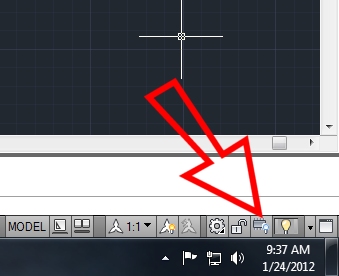

MILES9X Posted January 24, 2012 Posted January 24, 2012 I've been researching this on and off for about 2 months. The latest information that I have found is this. AutoCAD does this intentionally, when your computer enters into sleep mode or the screen saver comes on. It does this as preventative maintenance in order to prevent a crash or lock up of the system. From what I can gather, you can disable sleep/screensaver, close out of AutoCAD when you are away from your computer, or you can live with it. NOTE: Beginning with AutoCAD 2011, they added an icon in the lower right tray that allows you to easily toggle hardware acceleration back on, so it should save you a few steps of going into 3DCONFIG. Quote
