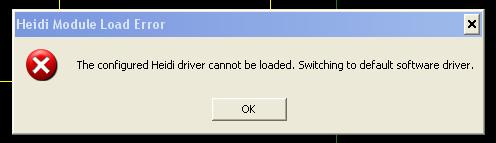

MikeP Posted March 10, 2009 Share Posted March 10, 2009 Why do I get this message every morning? "the configured Heidi driver cannot be loaded. Switching to default software driver." This happens every morning. My computer and autocad stays on overnight. What is happening throughout the night? Quote Link to comment Share on other sites More sharing options...

ReMark Posted March 10, 2009 Share Posted March 10, 2009 My guess is it has something to do with the display driver. There are two Heidi display drivers: Heidi Software and Heidi OpenGL. Are you using a 3D graphics card utilizing OpenGL? What graphics card are you using? Do you have an AutoDesk Subscription? Quote Link to comment Share on other sites More sharing options...

lpseifert Posted March 11, 2009 Share Posted March 11, 2009 Had the same problem here a while ago, this is the response I got from Acad support dated Jan 25, 2008. Thank you for contacting Autodesk Support. It appears that this is being caused by Google Desktop. Development is aware of this and it looking into the specific cause and a permanent resolution. In the meantime, please confirm that you do have Google Desktop installed. If you do not, please let me know and we can continue troubleshooting. If you do have it installed, please uninstall it, reboot your machine and confirm that it resolves your issue. Quote Link to comment Share on other sites More sharing options...

ReMark Posted March 11, 2009 Share Posted March 11, 2009 So far my searches regarding the error The configured Heidi driver cannot be loaded..." have yielded various answers to the problem. They are, in no particular order: Download and install the latest Service Pack. Reinstall DirectX from the product CD. Try switching from Direct 3D to OpenGL via 3DConfig, Manual Tune button. Switch to software graphics. Update your graphics card drivers to the latest versions. Turn off hardware acceleration. Exit AutoCAD. Open AutoCAD and turn hardware acceleration back on. Possible conflict with Netmeeting's remote desktop sharing. Disable this feature (in reference to Mechanical Desktop). Choose your poison. Personally, if either of you have AutoDesk Subscription I'd recommend getting on the horn to them and file a tech support request. That's one reason why you 'pays yo' money' as the man says. Quote Link to comment Share on other sites More sharing options...

nikki66 Posted July 22, 2010 Share Posted July 22, 2010 turned off screen saver and restarted computer and heidi driver error went away. thanks alot:D nikki66 Quote Link to comment Share on other sites More sharing options...

Skeeter Posted December 9, 2010 Share Posted December 9, 2010 This problem is caused by the 3D accelerator. Type in 3Dconfig, go to manul tune and turn it off. Quote Link to comment Share on other sites More sharing options...
