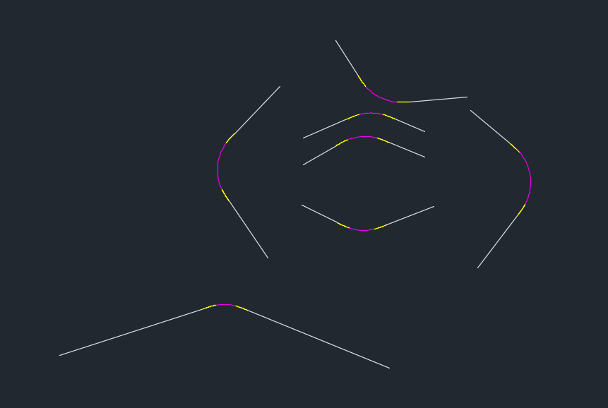

i'm trying to write proper code for the horizontal curve with proper transition and shifting of curve. but for some reason it is not working properly. please help me to find my mistakes.
; fillet 2 lines with arc & SPIRAL curves
; pcp maunsell adelaide nov 96ises extended entity data - application name "SPIRAL"

I can't correct your code, there are a lot of writing errors.
But I think I understand what you are talking about, so I suggest this which should make a transitional curve between a line and a circle.
clothoide.lsp idclo.lsp
In my 1980 road design handbook is the formula for transitions. So it would be best to post your reference before coding is done.
Harshad,
I managed to make your code works.  However there is still a lot of problem in it with subroutine returning result as global variable.
Also not sure what you want to do with all this extended data.  The computation for x and y were all order of magnitude wrong.
I recommend you download this paper The Clothoid Computation: A Simple and Efficient Numerical Algorithm  by Mendez and Urcera
for a simpler computation of the clothoid.
Here is your code where I changed a s little as I could.  Also did not check if it works in every orientation.
ymg

fspi.lsp
Edited by ymg3
Corrected link to article
The header contains a big consulting firm's name here in AUS it may have leaked out many years ago as hinted by the 96. It should match the Australian design of spiral road curves. You should check that it matches your design standards.
Found this https://cc4w.net/spiral/SpiralTraining.pdf
BIGAL,
Interesting find, however the app does not design the curve.  It simply draft the spiral given a spiral lenght an a circular curve radius.
The computation of the Clothoid aka Spiral aka Cornu aka Euler curve remains the same and is an approximation.
