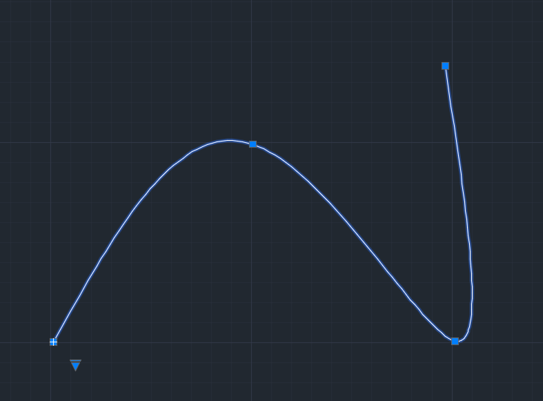

Those blue square points are fit points, first image attached. You have to click on it, and whether you have snap option on or off it should snap to it because you need to select it (square turns red), second attached image. If you are not able to select it like that, maybe you have to edit some snap or drafting options.
(command "splinedit" (entsel) "f" "a" (getpoint))
Works fine on AutoCAD 2000i on my home computer and AutoCAD 2024 at work.
