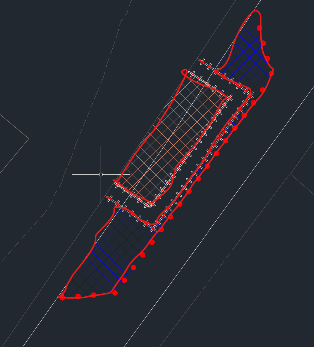

Is it possible to create a routine to autohatch once a closed boundary appears, basically linetypes are inserted from tool palette on certain layers and once they are inserted i have to hatch the boundaries manually, is it possible to hatch it automatically once the boundary has been created rather than manually doing it?

Bit hard to tell what is going on under the thick red line. You can in a lisp or at command level do Hatch "last".
-hatch s (entlast)
