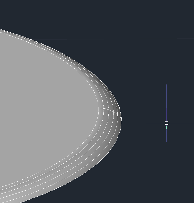

Hello everyone. Thank you for accepting me in the group. I am new to Autocad 2024 demo. Took days trying to figure out how to do this:
-Delete a rounding or modify a rounding that I already made.
-At the moment, I can only delete the entire piece and make it again.
How can I edit the rounding? The piece is like this:
-It is an extruded circle.
-When extruding it, I round off the edge.
-Then, what I want to do is edit the rounding already made, or remove it from that circle.
I would be very grateful if someone could guide me, I have searched Google and YouTube, and documentation, and I have not been able to do it.
You can try using the SOLIDEDIT command.
1. Run the SOLIDEDIT command
2. Choose the "Face" option
3. Choose the "Delete" option
4. Click on the curved edge to select it
5. Hit "Enter" to remove it
