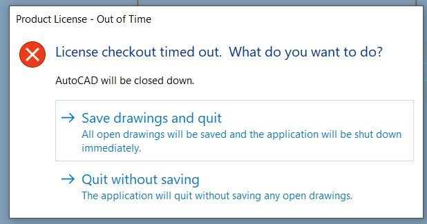

pefi Posted April 8 Share Posted April 8 (edited) I have a VBA script (in excel) that generates drawings. All worked fine up until yesterday. i suddenly started to get this message (see attached) every X drawings. I tried the autodesk provided solution (see link above the image - point 3), restarted the PC, but no change. the error keeps coming. I can restart the script and it works OK until the error comes back after X drawings. Anyone got the problem as well? Search on the forum shows I'm the only one, but it's hard to believe... Edit: AutoCAD 2021 Edit2: More info: https://www.autodesk.com/support/technical/article/caas/sfdcarticles/sfdcarticles/Error-License-checkout-timed-out-What-do-you-want-to-do-in-AutoCAD-2020.html https://www.autodesk.com/support/technical/article/caas/tsarticles/ts/A785RG35hP8oUR96WrYkn.html Edited April 8 by pefi adding version Quote Link to comment Share on other sites More sharing options...

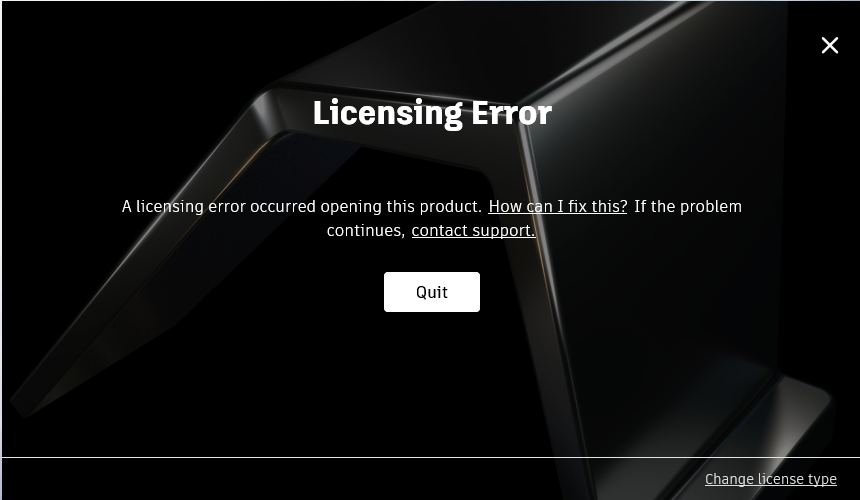

SLW210 Posted April 8 Share Posted April 8 I got licensing error last week and again this morning. I sent it all to IT, but haven't heard back. 1 Quote Link to comment Share on other sites More sharing options...
SLW210 Posted April 8 Share Posted April 8 PS. I didn't run any Scripts. 1 Quote Link to comment Share on other sites More sharing options...
pefi Posted April 9 Author Share Posted April 9 I think scripting might no be related, but might make the issue show up more often. I open AutoCAD 4-5 times per minute and modify probably a dozen attributes per second. I don't know exactly when the licence is checked, but judging from the moment my script dies it can happen during any operation. The "solution" is relatively new, so probably Autodesk messed something with the licencing server.... Quote Link to comment Share on other sites More sharing options...

pefi Posted April 9 Author Share Posted April 9 For whatever it is worth: the licence problem shows up every 150 seconds. Regularly. My IT dept. didn't provide any help so far. Quote Link to comment Share on other sites More sharing options...

pefi Posted April 10 Author Share Posted April 10 The problem doesn't show up when I'm on company VPN, so in my case it's probably some network configuration glitch that I won't be able to fix. I generated ~1k drawings yesterday without any problems after connecting to VPN. The VPN connection was required by IT to do a remote session, so as soon as the IT guy saw my screen the error stopped to show up... I felt a bit stupid after observing the error all day long and being unable to reproduce it in front of the IT. It took me whole night to link the dots... Quote Link to comment Share on other sites More sharing options...
