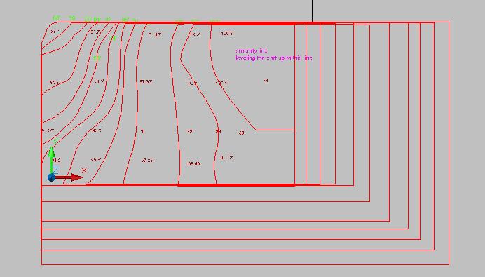

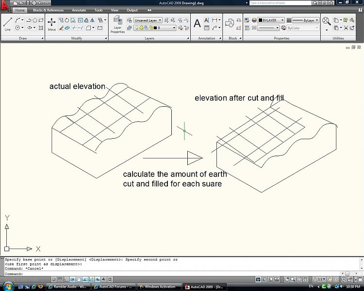

I drew a sketch of what i wish to obtaine
Do you think its possible at all?
Do u think its an efficient way of calculating cut and fill?
Its more of a civil technician task
My thinking is that once you have the chunk of earth leveled, you can calculate the excavation for foundation, draw the foundation in the excavated area, calculate the volume of concrete, calculate the backfill....
Any comments are welcome
Well from the contour lines you posted i think it would work because its a very small elevation change. The issue you will run into is while you do have elevation lines, the approximation of the land isnt perfect. For instance if one of your lines was at 99' and the land dropped suddenly but but not an entire foot until the next contour line, you are not going to know this and it wont be well represented in the model.
This certainly isnt my area so i am really not sure what to tell you on if it will be accurate enough or not. Maybe someone who does this type of work will chime in.

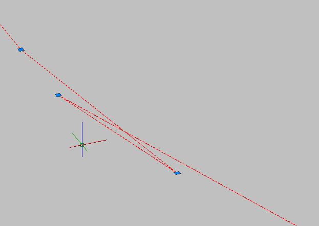

I was just messing with your drawing again and i found one of the issues. The second line(at 99ft) overlaps itself which is where one of the errors was coming from. I uploaded a screen shot of it below.
after you fix that second line, the loft works fine so this was the only issue. I just grabbed the control points(blue) and snapped them to the intersection to straighten out that one curve.
Use you LOFT by selecting the curves in order and get a surface model of the land. Using the closed surface option on the loft window is not a good option in this case. If you wish to have a solid model(which i think is what you need) you will have to add some stuff to your drawing. Below is a very quick addition just so you can see. What i did was at each elevation i create 3 or 4 more lines to create a closed sketch. I used PEDIT>Multiple, selected my lines(each elevation at a time so you will need to repeat this many times) and used the Join command. You could also use the REGION command which will be a lot faster in this case and still give you valid sections for a loft.
You can see in my drawing that none of the boxes line up. I suggest all your boxes end at the same XY coordinates only that they be on the Same Z level as your contour in each case. This will give you a solid "section" of the land.
If you need information about the material you are going to remove i suggest you setup some lines laying out your XY area and a line at your Z depth and perform SLICE 5 different times, each time selecting a plane and one of your lines as a slice reference. Keep Both sides each time. You should end up with a solid section(your removal area) and your land which now will be sliced into several pieces. Move the solid section of land and then use the UNION command to re join the rest of your "map".

I traced the contour lines just like you told me
as i've mentioned i've calculated the actual elevation in between contour lines where my grid lines intersect. (dark red color) contour elev.green. This is done for calculation of cut and fill.
than depending on each square elevation, you divide square by areas,calculate area,calculate average of the earth for that area to be cut /fill and that total cut and fill for that square

I understand you have the elevation between the contour lines but what the loft looks like between those contour lines can take on many different shapes. There are options for ruled/smooth fit, you can tell it what angle to enter/exit the lines etc. While this method might give you a good visual representation I dont know how accurate it actually is compared to the real thing.
