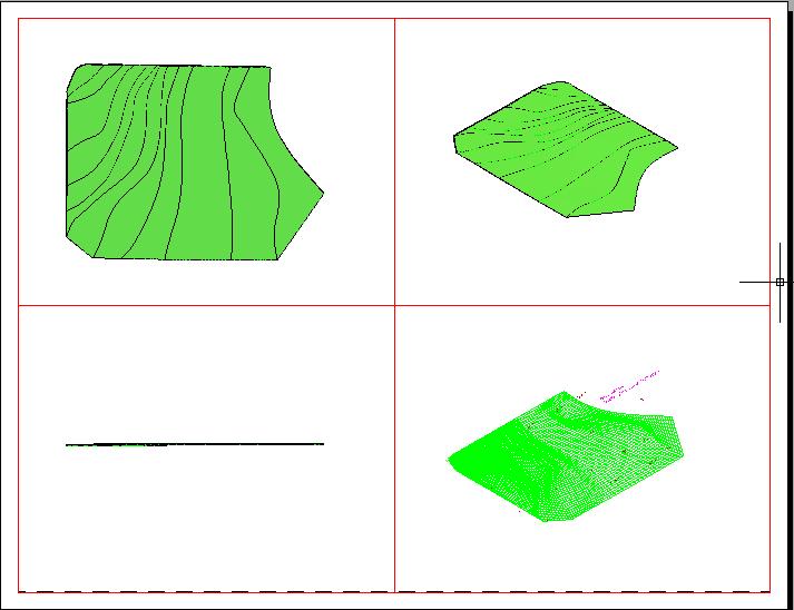

shift1313 Posted March 21, 2009 Posted March 21, 2009 okay so i wasnt able to do much with your curves except make a surface. The curves arent valid for the loft operation. What do you need to do with this model? here is a screen shot of what it looks like using EDGESURF with surftab1 = 50 and surftab2 = 10. From there you can run a lisp routine and make this a solid. I know you can perform a loft on Spline curves. your curves are 2d polylines and it will not let me loft with them. 2d polylines are typically okay to use a loft cross sections but i keep getting an error saying faces have more than one loop. Ill have to play with it a bit more because i havent run into this issue before. Quote
