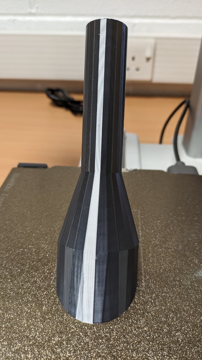

rwleigh Posted April 3, 2024 Posted April 3, 2024 Can anyone shed any light on why when i print objects that I've drawn perfectly cylindrical, they print with flats all the way round as seen in the attached photos. This is a little funnel i wanted and it works perfectly but just wondered why it does this, I've drawn it both with the cylinder command and the revolve command and it does this either way. Quote

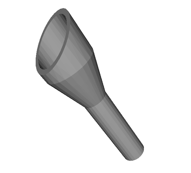

rwleigh Posted April 3, 2024 Author Posted April 3, 2024 Thought I'd try printing it the other way up on the 30° angled end to see if that made any difference... It didn't. Quote
SLW210 Posted April 3, 2024 Posted April 3, 2024 Hard to know without seeing the file. What type of object is it? Solid, Surface, etc. How is the model being sent to the printer, with a .dwg or some other file type? .stl? What is VIEWRES and FACETRES value? Quote
rwleigh Posted April 4, 2024 Author Posted April 4, 2024 It's a solid object i created myself and it was sent to the printer via Bambu Studio over Wi-Fi. See the STL file attached. VIEWRES is set to Y and FACETRES is 0.5. I've also tried printing it on our big Fortus 450mc with much the same result. It seams to be something to do with the slicing to me. merc2.stlFetching info... Quote
SLW210 Posted April 4, 2024 Posted April 4, 2024 FACETRES needs to be 10, IMHO. Lots of information on smoothing .stl files for 3D printing. The .stl looks like the printed object. Quote
SLW210 Posted April 4, 2024 Posted April 4, 2024 Maybe do a little reading up on .stl. AutoCAD 2017 Help | About Exporting Stereolithography STL Files | Autodesk Quote
rwleigh Posted April 4, 2024 Author Posted April 4, 2024 On 4/4/2024 at 10:25 AM, SLW210 said: FACETRES needs to be 10, IMHO. Lots of information on smoothing .stl files for 3D printing. The .stl looks like the printed object. Expand You're absolutely right, the FACETRES was causing the issue. Just tried 10 and it looks much better as an STL, printing now. Thanks for your help... Quote

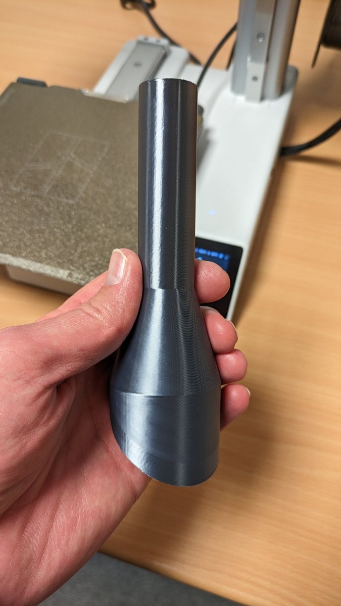

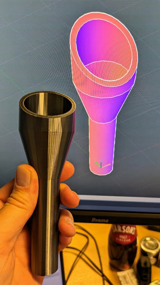

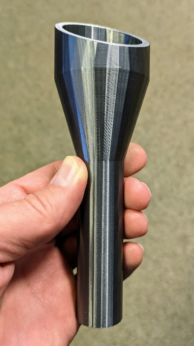

rwleigh Posted April 9, 2024 Author Posted April 9, 2024 Just as an update to this thread, here's a print showing just how smooth it looks now... 1 Quote
SLW210 Posted April 9, 2024 Posted April 9, 2024 What 3D printer are you using? What material? Glad it helped. Quote
rwleigh Posted April 9, 2024 Author Posted April 9, 2024 That was printed on a Bambu Lab A1 mini using this silk filament which i find really good for the price. ZIRO PLA Silk. Quote
