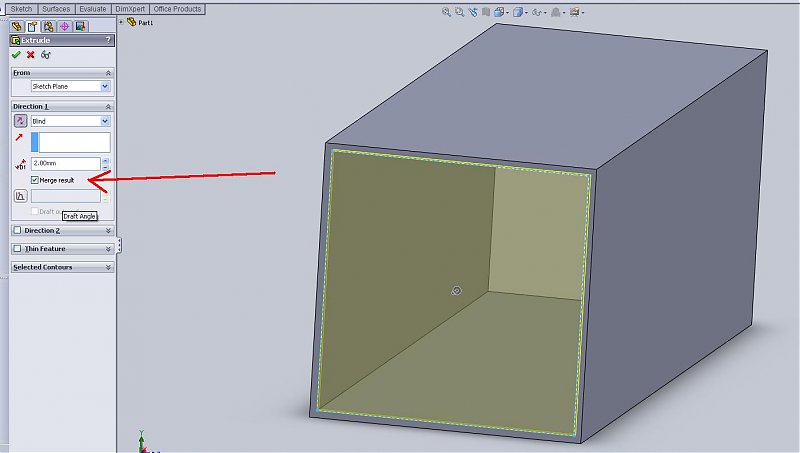

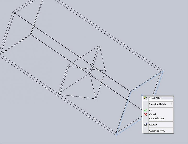

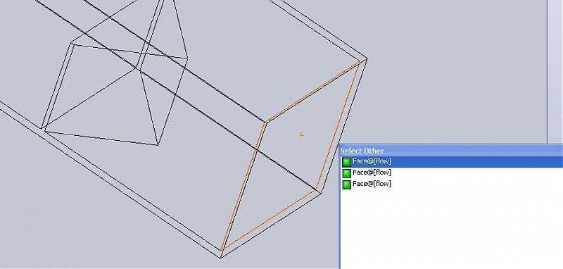

shift1313 Posted March 6, 2009 Posted March 6, 2009 when you created your box/lids did you use merge for your parts? meaning are your lids actually part of the box or just there? Are you using flow works or flow express? FlowWorks doesnt need a box so im assuming you are using FlowExpress. Flow Express may not give you the resolution you want. I see from your design tree that you need to rebuild the part. When you are selecting the lids put your cursor over the end and right click, select other. Quote

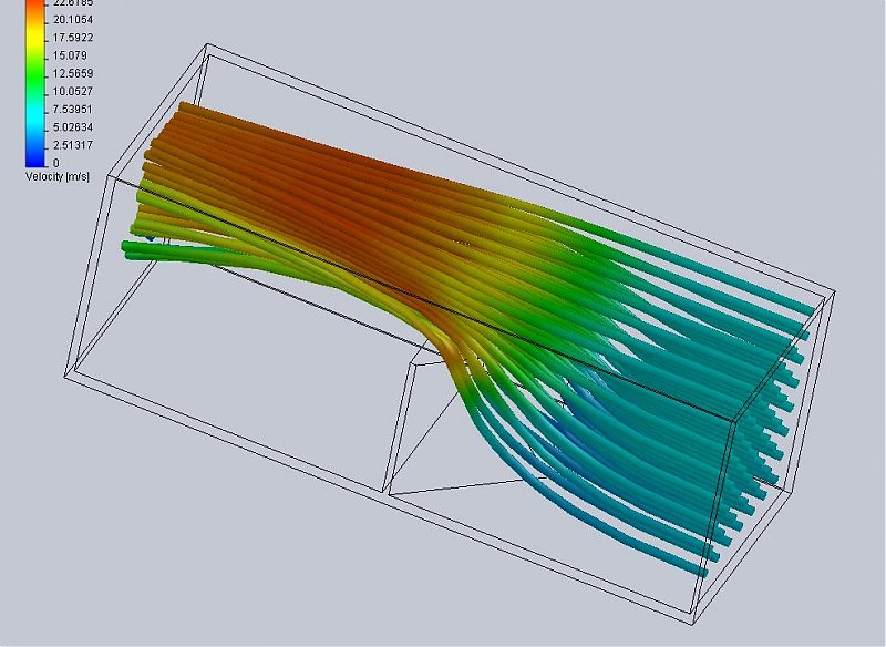

JoshC Posted March 6, 2009 Author Posted March 6, 2009 here is what I dont get about what I am doing atm. I have done it several times and all have been sucessful and after several flow works and practical testing what you see above I am on mk 4.625. it was working perfectly before but for some strange reason it dosn't work now. I have used both the tutorial style of caps and your recomendations but still no results. I even asked my university lecturer and he has no clue why it has happend. I would submit a picture but I dont have enough posts yet Quote
shift1313 Posted March 6, 2009 Posted March 6, 2009 well the problem you posted said you couldnt select the lids but the picture you just posted looks like a solved model. does this mean you got it? Quote
JoshC Posted March 7, 2009 Author Posted March 7, 2009 thats the previous model which I have changed. it's just to show that I can do it. when I swap that item with it's improved counter part it just says that there are no lids and wont let me get any further. Quote
