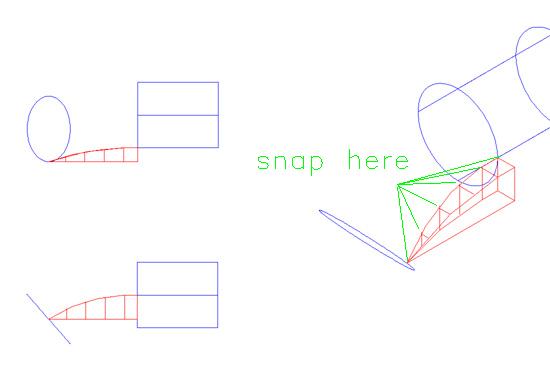

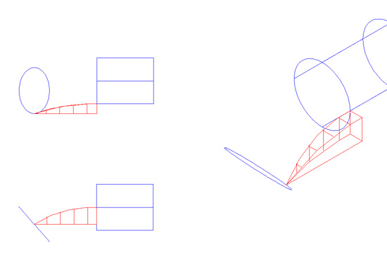

CAD_e_shack Posted March 5, 2009 Posted March 5, 2009 Hello, I'm trying to follow along with all the advice on making pipe joints but I hit a snag. I want my pipe/tube to follow the edge shown below. The beginning and end of the joint are slightly offset. The path I created is an arc in the side view and an arc in the top view. (the intersection of two solids) When I try to extrude along the path of the edge I get an error "cannot extrude along this path". I can extrude along a 3d arc created between the two points, but the result would be a straight line in the side view or top view (depending on the way I set the UCS). I'm game for any ideas just looking for a nice curve. This is not for work, just a model I'm fooling around with. I will use this technique to create exhaust ports on an engine. PS im on AutoCAD 2005, no loft or sweep commands. Thanks Quote

shift1313 Posted March 5, 2009 Posted March 5, 2009 if your red piece is a single object you can explode it twice and it will leave you with your line to use as a path(although i dont know if this is a valid path in 05). easier thing to do would be to draw a spline using your curve intersection points to snap to. Quote
CAD_e_shack Posted March 5, 2009 Author Posted March 5, 2009 Thanks guys. For what ever reason it does not like the edge of the solid. I'm trying some splines now. Any tips on making good splines in 3d? Mine seem to be jumping all over the Z axis and making tight little radii at the ends. Thanks again Quote
shift1313 Posted March 5, 2009 Posted March 5, 2009 you cant use a solid edge as a path as far as i know. for drawing your spline, just use the edge of your existing solid. Typically the fewer control points used will give you a better spline but in this case i would snap to all of them. like indicated below. Quote
shift1313 Posted March 5, 2009 Posted March 5, 2009 also i dont remember but i think your path needs to be in the center of your profile. I have 05 at home so i can try this. I have a bad feeling that you can not use splines for extrude paths in 05. If not one thing you can try is to create a ucs so that an arc can lay in that xy plane and use an arc. Quote
CAD_e_shack Posted March 5, 2009 Author Posted March 5, 2009 finally! spline was a good suggestion, but in the end 05 could not extrude along the path of the spline (at least when I tried). You are correct Shift. I figured out how to get a pline to follow the edge by moving the UCS so that x is on the bottom edge and y is diagonal across the end of the solid. Its not pretty but I'll fine tune it. Thanks again Quote

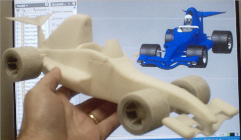

CAD_e_shack Posted March 5, 2009 Author Posted March 5, 2009 cool shift, I am doing a Formula One car, starting at the engine and working my way out. I'll let you know when I get to the sequential gearbox (which I believe is almost identical to a motorcycles) for some knowledge. At this rate... should only be a few more decades. (At least then I'll be able to send it out to a desktop 3D printer) Quote
shift1313 Posted March 6, 2009 Posted March 6, 2009 are you doing the entire thing in acad05? if so you are going to have some real fun when you get to the body. Quote
JD Mather Posted March 6, 2009 Posted March 6, 2009 I am doing a Formula One car, ... (... send it out to a desktop 3D printer) Something like this? Quote
CAD_e_shack Posted March 7, 2009 Author Posted March 7, 2009 Neat JD, Ive been reading your tutorials thanks. Quote
Came Posted March 7, 2009 Posted March 7, 2009 nice tutorial did you made that wooden staff , if did give some tips am learning basic Quote
shift1313 Posted March 8, 2009 Posted March 8, 2009 it wasnt drawn in acad 05 JD, no fair:) i see inventor in the background Quote
