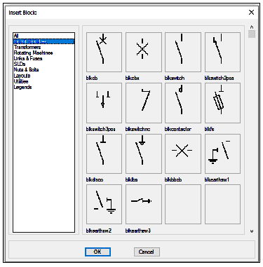

This is my current amusement, more visual than remembering all the block names - I think you have posted similar before (a few times).
Edited by Steven P
Thats an image out of a pop menu, nice thing is when screen is full it supports next so a full screen again. Select image or text.
Best is that you can use Notepad to make, the images are slides but I made like a 100 in one go.
Yes, that the image of the one I made up - very similar layout to the rest though, it is all working, just got to populate the menus now.
(doing it for my amusement and to help my memory with block names, thinking I'll make pseudo tabs for fun (Electrical, Civil, Mechanical, Drawing Utilities and so on))
