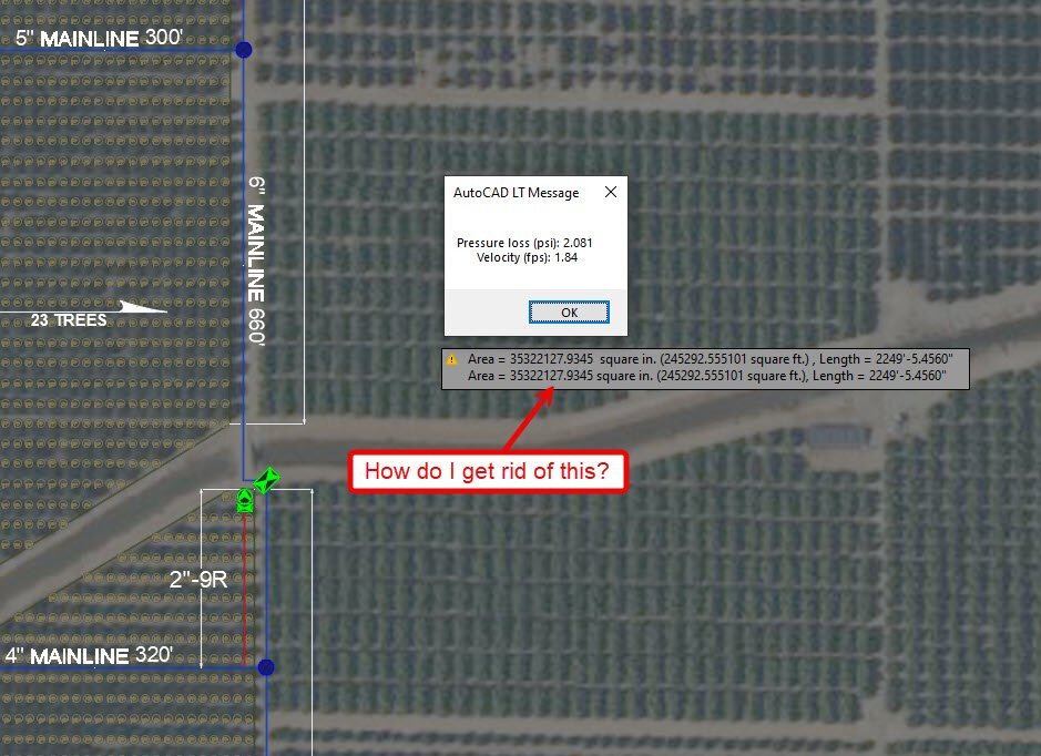

Quick question, I know it's in the TLEN section, but is there a way to get rid of the perimeter/area/length display?
Thank you.
