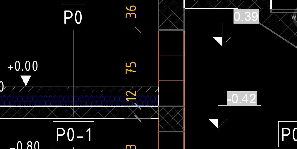

Butch Posted March 20, 2024 Author Posted March 20, 2024 Thanx! Once the lisp is loaded, the first time it asks for global scale.....how to change the gobal scale latter on? Is it possible to define custom elevation marker like in the capture (triangle) Quote

Butch Posted March 20, 2024 Author Posted March 20, 2024 Im attaching my elevation marker. Its made from hatch, line (0,18mm linewidth), and text (wich is either 10 or 20 units high). Any chance this could be incorporated? elevation marker.dwgFetching info... Quote
Tsuky Posted March 20, 2024 Posted March 20, 2024 (edited) @Butch I incorporated your marker For the '+' sign I put it as a prefix, there is no other way with the fields (you cannot make conditions in them). The downside is that for negative numbers it will display '+-'. If you want to return as before, remove the '+' on line 471 (leaving the comma after) level-pt(Butch).lspFetching info... Edited March 21, 2024 by Tsuky Improved code for inserting '+' and '-' sign 1 Quote
Nikon Posted March 20, 2024 Posted March 20, 2024 (edited) On 3/20/2024 at 2:18 PM, Tsuky said: I incorporated your marker Expand If you run level-pt(Butch).lsp and level-pt.lsp in the same file, then the blocks are displayed incorrectly, since they have the same name "LEVEL-OBJ". This name needs to be changed in the level-pt(Butch) lisp, for example, to "LEVEL-OBJ1", or don't use lisps in the same file. Edited March 20, 2024 by Nikon Quote
Tsuky Posted March 20, 2024 Posted March 20, 2024 @Nikon I customized it for Butch, I think he will only use this one, so the block names (although you are right) don't matter. I even took his definition of his marker from his DWG which keeps the same appearance.. Why use a solid hatch when a simple solid has exactly the same appearance, it unnecessarily weighs down its definition. Its text has a Z at -11.88, why?!! The properties are of the bylayer and not of the byblock. Object definition coordinates have decimal places up to the maximum that autocad can display, completely useless for a symbol. Why make it simple when you can make it complicated... This marker symbol block was done on the fly over the leg in my opinion, so!.... 1 Quote

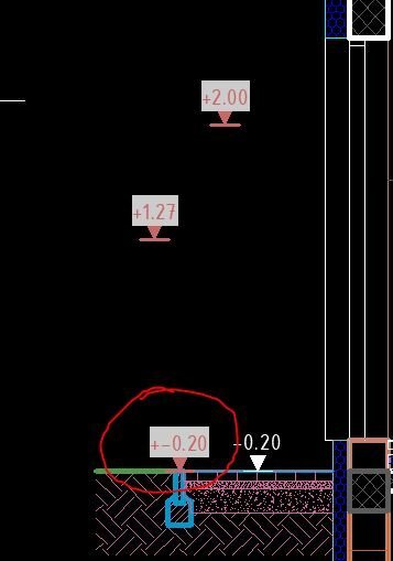

Butch Posted March 21, 2024 Author Posted March 21, 2024 Tsuky thnk you ver yver ymuch for this! But there is a problem....see attached....when the elevation marker is set below the reference point, I get + and - signes together. Can you fix this? Quote

Tsuky Posted March 21, 2024 Posted March 21, 2024 @Butch Finally I managed to solve the problem with the sign "+/-". I updated your custom code in the relevant post. Please re-upload it. 1 Quote

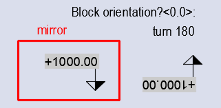

Nikon Posted March 21, 2024 Posted March 21, 2024 (edited) On 3/21/2024 at 12:31 PM, Tsuky said: @Nikon I also updated the original LEVEL-PT code in the relevant post by including the scale and the sign "+/-" Expand @Tsuky That's great!!! Thank you very much!!! *** *** *** There is only a question of the orientation of the block to the left... This cannot be solved by turning... This is not necessary... I can use a mirror... Edited March 21, 2024 by Nikon Quote
Butch Posted March 21, 2024 Author Posted March 21, 2024 On 3/21/2024 at 12:24 PM, Tsuky said: @Butch Finally I managed to solve the problem with the sign "+/-". I updated your custom code in the relevant post. Please re-upload it. Expand Thank you very much! ITS WORKING! Quote

Nikon Posted March 22, 2024 Posted March 22, 2024 (edited) I am changing (cons 1 (rtos 0.0 2 3)), I add it at the beginning of the code: (setq olddimzin (getvar 'dimzin)) (setvar 'dimzin 0) and at the end of the code (setvar "dimzin" olddimzin) block 0 is displayed as 0.000 Can add a mirror request to the code? Or is it difficult? Edited March 24, 2024 by Nikon Quote
