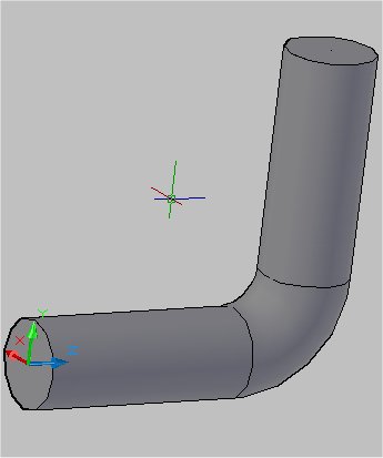

Cunoblin Posted March 3, 2009 Posted March 3, 2009 hey all, I'm trying to make some pipe joints - i've made a Tee so far - that was easy. but now i'm stuck making a 90deg elbow. i have the 2 ends, hollowed.. but I can't seem to join them in a sweeping arc - the elbow part of it.. and no commands i am seeming to use are working. any suggestions? thanks Quote
L_Ruts Posted March 3, 2009 Posted March 3, 2009 Draw the centerline radius arc, then extrude the circle along the path of the arc. Command: EXTRUDE Current wire frame density: ISOLINES=4 Select objects to extrude: Specify height of extrusion or [Direction/Path/Taper angle]: P Select extrusion path or [Taper angle]: Quote

nialb Posted March 3, 2009 Posted March 3, 2009 I am no expert in 3D and really only started to dip my toe this week. I have attached one of my efforts that is probably an example of what you want to do. Ignoring the handrail standards, the way I created the hollow bent tubing is as follows; I created a 2D path using lines and an arc. I converted the lines to a polyline (Modify/Object/Polyline). In an isometric view I rotated the UCS and drew the outer diameter circle of the tube. I then drew the inner diameter. I extruded the inner and outer to 'path' (Draw/Solids/Path). Next I subtracted the inner from the outer to give a hollow pipe (Modify/Solids Editing/Subtract). Finally I deleted the path. Well that is how I went about it but I'll bet there are loads of other ways. Hope this helps. Nial 3D Railing.dwg Quote

JD Mather Posted March 3, 2009 Posted March 3, 2009 The SWEEP command does not have a distinct advantage over EXTRUDE in this application. The Sweep command has a distinct advantage over Extrude in this application as you don't need to have the profile aligned with the path. Simply create a "library" of region profiles you commonly use in your pipe runs. Create the pipe run skeleton (of course arcs for bends are planar entities so you will need to learn the UCS command) and then Sweep. The Sweep will automatically align the center of the profile to the path - so the orientation of the profiles is irrelevant. Can lighting fast populate runs of different diameters. Far faster than could be done with Extrude. http://home.pct.edu/~jmather/content/CAD238/AutoCAD%202007%20Tutorial%208.pdf Quote

Cunoblin Posted March 4, 2009 Author Posted March 4, 2009 YAY... thank you so much... i was so trying it the wrong way at first... I made the arc and the circle... extruded it along the path.. made a 2nd one just slightly smaller and subtracted them to get the hollow pipe.. it's not perfect.. but it's working thanks everyone. Quote
