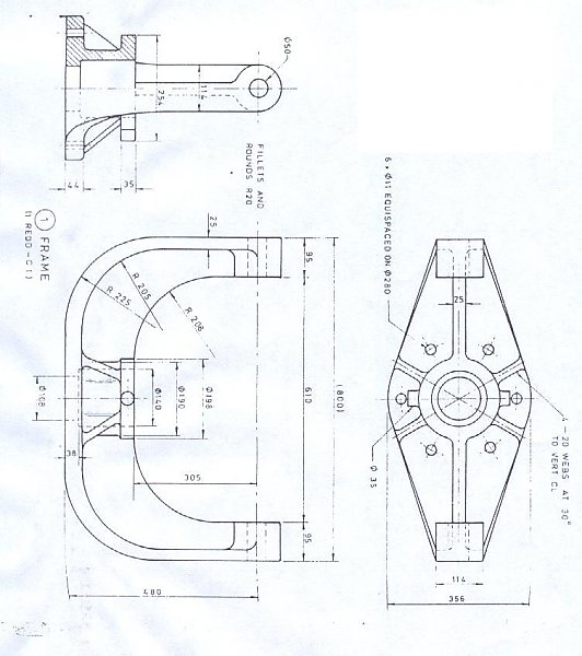

linnmaster Posted February 24, 2010 Posted February 24, 2010 In the second example if you try to extrude (the closed profiles) as a test there is no red cross. I still see a red cross. Click on the red cross, and it runs through it's diagnosis and picks up the open profile on the sketch that contains the rails .... Hence I can't really see any difference between rev1 and rev2, except one works with loft as solid, and the other needs to be lofted surface first, then sculpted. Quote
linnmaster Posted February 24, 2010 Posted February 24, 2010 Did you take a look at the Rev2 file I posted? You need to be careful where you select the edges for the loft. Click on the planar faces near the edge or the tangency will be to incorrect face. Note also that must have existing solid faces or surfaces to get the tangent options. Lofts with sketches do not give this option. Ahhh! I see! Thanks so much for the clarification and pointing to where the issue might be. Oh, and yes, I looked at Rev2. Regards, David Quote
JD Mather Posted February 24, 2010 Posted February 24, 2010 I still see a red cross. Click on the red cross, and it runs through it's diagnosis and picks up the open profile on the sketch that contains the rails .... Not the rail sketch - that one is open and therefore should have a red cross. Quote
lis_wang Posted February 24, 2010 Posted February 24, 2010 Not the rail sketch - that one is open and therefore should have a red cross. Your Rev2 file has a minal mistake, the dimension 38 for sketch 3 is from side to side, instead of from center to center. Thank you very much JD. Quote

lis_wang Posted March 1, 2010 Posted March 1, 2010 I cannot do the loft portion for the frame. The trail looks like a 3D sketch. Please see what I have done. frame_SVOG.zip Quote
JD Mather Posted March 1, 2010 Posted March 1, 2010 Everyone else - give it an honest try before you look at my example. Just realized I made a slight mistake - change the 38 dimension in Sketch1 to 44. Change Thicken1 to 44 as well. I realized that I didn't need the second extrude surface and be very very careful with ribs. Keep in mind that when we drew in 2D that rib extents are simplified. In 3D we have to be a bit more true to the real geometry. Frame.zip Frame_Rev1.zip Quote
lis_wang Posted March 2, 2010 Posted March 2, 2010 Everyone else - give it an honest try before you look at my example. Just realized I made a slight mistake - change the 38 dimension in Sketch1 to 44. Change Thicken1 to 44 as well. I realized that I didn't need the second extrude surface and be very very careful with ribs. Keep in mind that when we drew in 2D that rib extents are simplified. In 3D we have to be a bit more true to the real geometry. Dear JD Your method is excellent. I tried to use LOFT with 3D sketch trails. It looks very bad. frame_SVOG.zip Quote
pinco pallino Posted March 22, 2010 Posted March 22, 2010 I cannot do the loft portion for the frame. The trail looks like a 3D sketch. Please see what I have done. Hi Lis if that fork is to be cast in sand or forged those concentric ribs around the big hole are making an under cut that's a trouble for pattern making and it will cost big dollars to produce consider make them perpendicular to the the join line (larger surface). Regards Ralf engineering pattern-maker designer Quote
lis_wang Posted March 22, 2010 Posted March 22, 2010 Hi Lis if that fork is to be cast in sand or forged those concentric ribs around the big hole are making an under cut that's a trouble for pattern making and it will cost big dollars to produce consider make them perpendicular to the the join line (larger surface). Regards Ralf engineering pattern-maker designer What do you mean by " perpendicular to the the join line "? Thanks Quote
