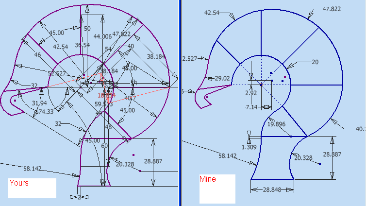

JD Mather Posted March 3, 2009 Posted March 3, 2009 Go through these tutorials - especially MA13 and MA 105 http://home.pct.edu/~jmather/content/DSG322/inventor_surface_tutorials.htm Your sketches are unconstrained and the rail connection points not projected to the cross-section profiles. You are doing way to much work with far far too many dimensions. Start using sketch constraints like = to replace duplicate dimensions. (Let me guess - you brought this in from AutoCAD and used the Autodimension?) Use the origin and BORN techniques as described in the linked documents. Quote

JD Mather Posted March 3, 2009 Posted March 3, 2009 Red_Stafford said: you post kind of lost me... When you read those documents you will see that I suggest sketching one line, arc or polygon and dimension it immediately. Then as you add additional geometry dimension (preferably use sketch constraints like tangent, horizontal, vertical, coincident, colinear...) as you go. When geometry is fully defined it will turn color. Notice that my sketch (see attached) is much cleaner than yours and I needed far fewer dimensions. I never ever use Autodimension. Until you understand the techniques for building robust, fully constrained sketches I would work on easier parts than this one. Loft is an advanced function. Quote

JD Mather Posted March 4, 2009 Posted March 4, 2009 Red_Stafford said: I have sketched and dimensioned a circle see attached. I do not see any evidence that you read the documents I suggested earlier. Pay particular attention to http://home.pct.edu/~jmather/AU2007/MA105-1L%20Mather.pdf Tip #8 to turn on the visibility of the origin and Project Geometry the origin Center Point. You want this to be at a logical location in the part. There is no point in continuing until that basic principal is understood. Out on the shop floor the first thing the mill or lathe operator does in setting up a job is determine 0,0 location. I looked at your hook 4 - I never ever use Fixed constraint - use the origin. Also you need to use many many more tangent contstraints where appropriate and also = constraints. If you see dimensions repeating over and over again (like for fillets) there should be only one dimension with the rest replaced with = constraints. Quote

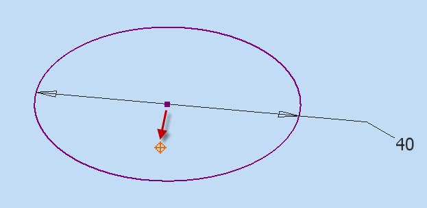

Red_Stafford Posted March 4, 2009 Author Posted March 4, 2009 Ok, see attached circle I have turned the center point on. 35mm Cricle.zipFetching info... Quote
JD Mather Posted March 4, 2009 Posted March 4, 2009 Nope See Tip #4 to Autoproject part origin on sketch create and tip #10 for green "hard snap" placing coincindent constraint. If you do not see this green dot then you need to Project Geometry the origin Center point yourself (rather than relying on automatic as decribed in #4. Project Geometry will be one of the most important concepts in creating the section profiles for this hook. If you can drag your circle it isn't anchored. It didn't change color - so it isn't constrained. Think of it like dropping a block of aluminum on the milling machine table and trying to make a cut. If you don't anchor it down all kinds of bad stuff is going to happen. No machinist could ever get away with work like this. Of course because we are doing this step-by-step over the internet it will be far more frustrating and far less efficient than classroom training. JD Certified Machinist Quote
