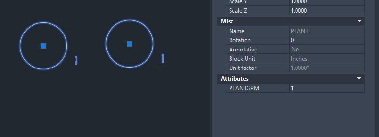

I never worked on LT, nor I have where to try it. In full AutoCAD I run the program and in the command line appeared the result.
Please give it one more try and after the lisp finishes, press F2 to switch to the text screen and post here what you see.
Command: PP
Select objects: Specify opposite corner: 2 found
Select objects:  2
At the prompt "select objects" you selected those two blocks. After you pressed ENTER in the command line it says 2 - that's the sum.

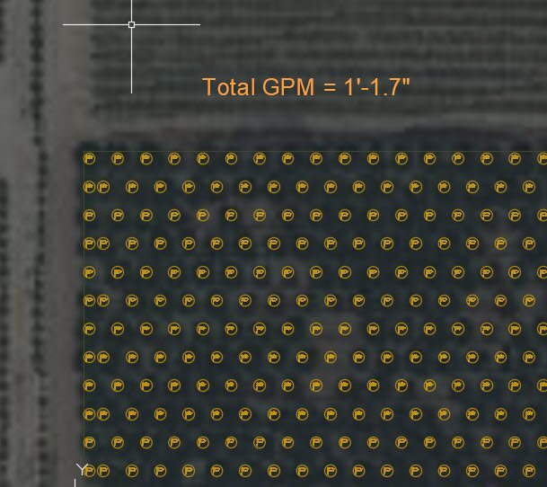

This is very close.  It outputs the total as a measurement (ft-in).  I need just a plain decimal number.
Thank you!
Please find at the end of the program a call to RTOS function.
Replace (rtos sum) with (rtos sum 2)
(rtos sum 2 0) will return an integer answer
(rtos sum 2 2) will return a real answer with 2 decimal places
So second number controls decimal places.
