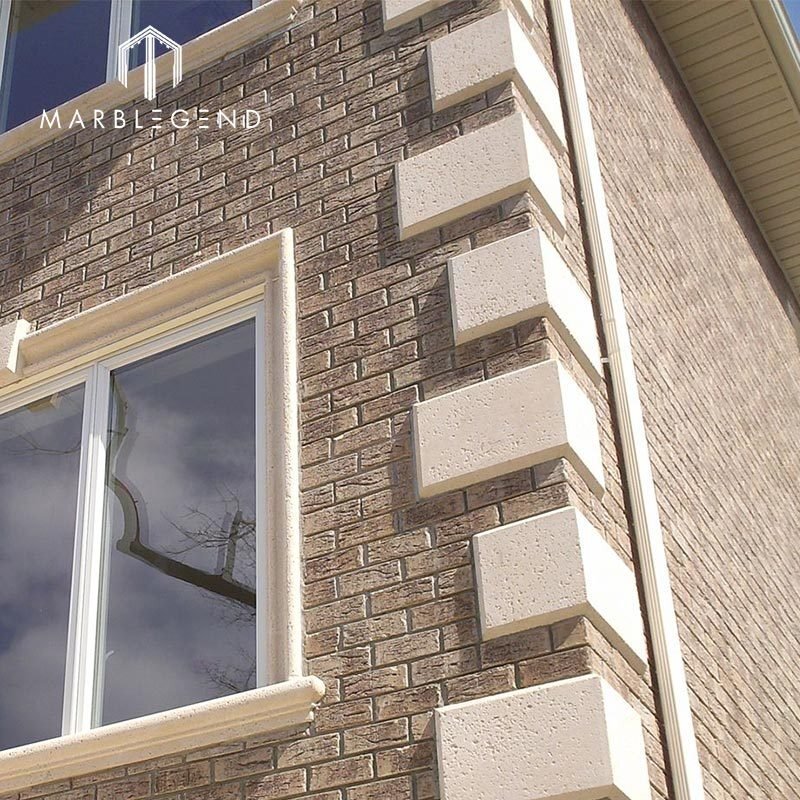

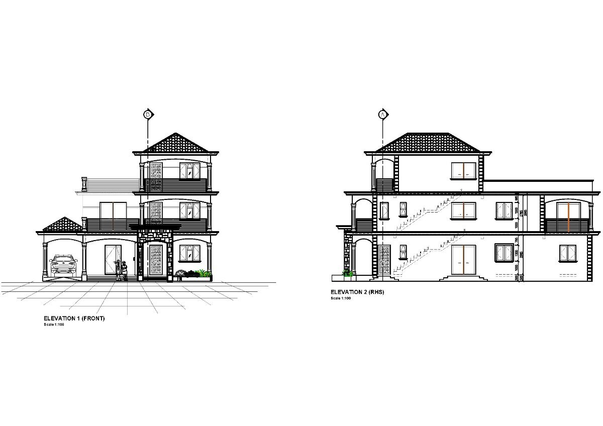

nicolas Posted March 4, 2024 Posted March 4, 2024 HI, I am looking for some feedback on improving the roof tiles covering. Your inputs are most welcomed. Thanks. I am also looking for some decorative window surround like in the attached picture. If any of you can forward same to me, I will be most grateful. Thanks. GroundFloorLayout.pdfFetching info... RoofLayout.pdfFetching info... RoofTiles 00.dwgFetching info... RoofTiles_Elevation.pdfFetching info... Quote

ReMark Posted March 4, 2024 Posted March 4, 2024 (edited) Re: decorative window surround. What you are looking for is concrete trim molding for windows. Suncoast Stone and Laguna Precast are two suppliers for such products. Your depiction of roof tiles looks fine to me. What's the problem? BTW... the roof tiles are referred to as Spanish tile, barrel tile roofing and clay barrel tile. One supplier is Brava Roof Tile. Edited March 4, 2024 by ReMark Quote

Joshmilo Posted July 3, 2024 Posted July 3, 2024 Regarding the decorative window surround in the attached picture, it looks like a stylish and classic design with a stone or concrete finish. You might want to check with local suppliers of architectural stone products or masonry companies. They often have a range of decorative elements like the one in your image. Additionally, many home improvement stores or specialty websites offer custom orders for such decorative surrounds. Let me know if you need more detailed information or have other questions! Thanks. 1 Quote
