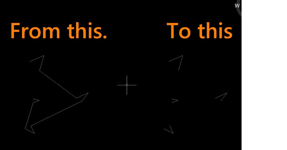

Alternating poly line trim routine. (edit of previous lisp)
A while back I asked for some help with a routine that could trim unwanted segments of a poly line.
original post:
Steven P came up with a solution that works perfectly. However I've been trying to make a second version that deletes every third section of the poly line.(example below) but haven't had any luck😢any help would be greatly appreciated.
(Edit) Steven P original code:

I think make this line:
(setq acount (+ acount 2))
to
(setq acount (+ acount 3))
I'll check next week (if I remember, if not remind me), I think adding a 'remove every nth' user control would make this more versatile and maybe better?
@Jamesclark64
This can do the job?

Try this, command is oddeven again, and this version will ask which single vertex to remove (as above, delete every 3rd, or in the original every other, or even every 100th)
Suppose it could even be altered to add "start vertex" and "number of vertex to remove" but that isn't for a Sunday night though
Fantastic work 👏 can't thank you enough.

(defun c:altern_poly ( / ss n ss_save ent dxf_ent lst_pt brk_pt)
  (while (not (setq ss (ssget '((0 . "LWPOLYLINE"))))))
  (repeat (setq n (sslength ss))
    (setq
      ss_save (ssadd)
      ent (ssname ss (setq n (1- n)))
      ss_save (ssadd ent ss_save)
      dxf_ent (entget ent)
      lst_pt (mapcar 'cdr (vl-remove-if '(lambda (x) (/= (car x) 10)) dxf_ent))
    (if (equal (append (car lst_pt) (list (getvar "ELEVATION"))) (vlax-curve-getendpoint ent) 1E-08)
      (setq lst_pt (append lst_pt (list (car lst_pt))))
    (if (>= (length lst_pt) 3)
        (setq brk_pt nil)
        (while (and lst_pt (cadddr lst_pt))
          (setq
            brk_pt (cons (caddr lst_pt) brk_pt)
            lst_pt (cdddr lst_pt)
            brk_pt (cons (car lst_pt) brk_pt)
        (if (eq (boole 1 (cdr (assoc 70 dxf_ent)) 1) 1) (setq brk_pt (cdr brk_pt)))
        (cut@point ss_save brk_pt)
  (prin1)
