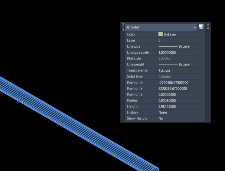

Tengo activadas las propiedades para los sólidos en el CUI, y puedo ver las propiedades geométricas en la tabla de propiedades rápidas (altura, radio) cuando recién hago el elemento en 3D, por ejemplo un cilindro, salvo el archivo y salgo, al reabrir el dibujo no se muestran las propiedades en tabla de las propiedades rápidas, alguien sabe porqué?

Thanks for reading me and your welcome, I thought it would be easier to write my question en spanish, I'll explain what happens, I have, in the CUI activated the properties for all solids for example a cylinder (radio, Height, Z, etc,) so I can edit them in the quick properties tab, I save the drawing and quit, when I reopen the drawing i can't edit the properties in the quick properties tab because they are missing and don't know why? I hope explained correctly what's the problem.

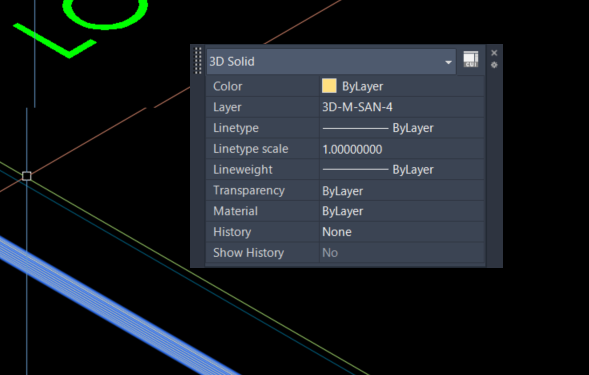

Hi Angel, thanks for your help, specifically what I want is to modify the properties of 3D cylinder (height and radius) everytime time I need to, perhaps, as you say, AutoCAD do not keep properties editable for every session, but I have a sphere in the same file and it keeps editable properties in the quick properties tab... that's why no make sense to me..
In this image I already draw a cylinder and appears their properties, in previous is an cylinder draw in last session.  Sometimes the project changes and have to edit the lines and is easier just to edit the properties than draw again the line.  Hope I cleared what I'm looking for.

If you use the main Properties window, it will persist from session to session. You can use it to change height, radius, and much more.
Tell us more about what you're doing, and we may be able to find a simpler way than modifying properties.
