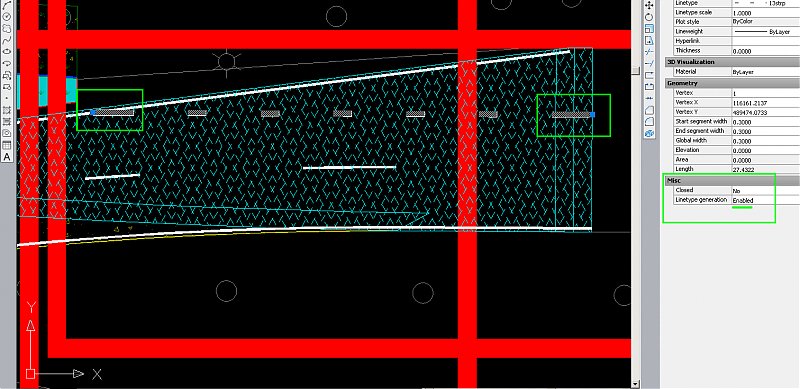

In the attachment i got an situation where a line fillsout the end, and it always does that no matter what drawing.
Can this be helped bj some command setting or might this be an 'error' in the custom linetype?
If the last case is at order, how can it be fixed ?
Anyone have any idea ???

Well, no promises here, but your resolution will probably lie in the addition of a new Linetype. All of AutoCAD's Linetypes expect that you're going to want to draw from the endpoints and as such, when you turn on the Linetype Generation, it will draw in the extra as you have shown. If it's Disabled, it will just start at the beginning and finish however at the other end.
