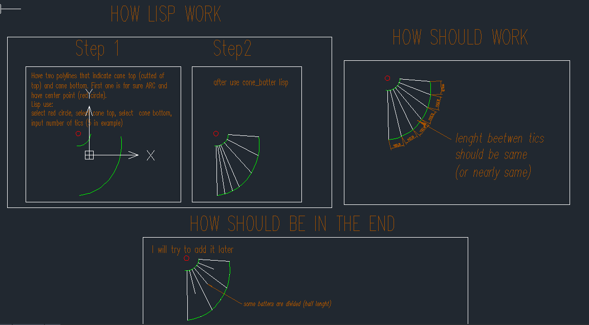

zwonko Posted February 28, 2024 Posted February 28, 2024 Working in bridge engineering so often must to draw cone batters (slope-lines for cone). Tried to make it but something is not ok. The main thing us that batters are not in the equal lenghts. Everything is in attached DWG (and also screen). Code below: (defun c:cone_batter (/ ent1 ent2 pline i pt1 pt2 pt3 dist sset1 ent2 sd slo new_ent new_ent2 elev len1 len2 n_bat point intersection all_entities newpoints) (setq point (getpoint "\n Select cone center point (top): ")) (setq ent1 (car (entsel "\n Select a TOP polyline: "))) (setq ent2 (car (entsel "\n Select a BOTTOM polyline: "))) (setq n_bat (getint "\n How many batter tics: ")) ;(setq elev (vla-get-Elevation (vlax-ename->vla-object ent))) ; read the elevation of the polyline (setq i 0) ; reset i at the start of each iteration (setq len1 (vlax-curve-getdistatparam ent1 (vlax-curve-getendparam ent1))) (princ "\n") (princ len1) (setq len2 (vlax-curve-getdistatparam ent2 (vlax-curve-getendparam ent2))) (princ "\n") (princ len2) (princ "\n") (princ n_bat) (princ "\n") (princ (/ 1 (float n_bat))) (setq all_entities (ssadd)) ; Initialize the list of all entities (setq newpoints nil) ; Initialize the list of intersection points (repeat (+ n_bat 1) (setq pt1 (vlax-curve-getPointAtParam ent1 (* (vlax-curve-getendparam ent1) (* i (/ 1 (float n_bat)))))) ; get the point at each 1/10 of the polyline (princ "\n") (princ pt1) (setq pt2 (vlax-curve-getPointAtParam ent2 (* (vlax-curve-getendparam ent2) (* i (/ 1 (float n_bat)))))) ; get the point at each 1/10 of the polyline (princ "\n") (princ pt2) (entmake (list (cons 0 "LINE") (cons 10 point) (cons 11 pt2) ) ) ;entmake end (princ "\n created center to end line") (ssadd (entlast) all_entities) (setq intersection (vla-IntersectWith (vlax-ename->vla-object ent1) (vlax-ename->vla-object (entlast)) acExtendThisEntity)) (princ "\n intersection found") (setq intersection (vlax-safearray->list (vlax-variant-value intersection))) (princ "\n") (princ intersection) (princ "\n") (entmake (list (cons 0 "LINE") (cons 10 intersection) (cons 11 pt2) ) ) ;entmake end (setq i (+ i 1)) ) ; Delete all entities created in the loop (princ "\n now trying to delete") (sssetfirst nil all_entities) (princ "\n now trying to delete") (if all_entities (command "_.Erase" all_entities "")) (princ "\n after delete") ) cone_batter.dwgFetching info... Quote

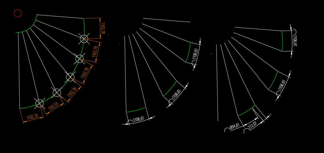

lrm Posted February 28, 2024 Posted February 28, 2024 (edited) Trimming each segment shows that the arc length for each segment is the same. The second segment is composed of two arcs. Add them together and you get 1106.6 Edited February 28, 2024 by lrm Quote
zwonko Posted February 28, 2024 Author Posted February 28, 2024 Yes, but You took part which is hand made with divide command. Not by lisp, which is in step2 rectangle. Quote

lrm Posted February 28, 2024 Posted February 28, 2024 (edited) @zwonko The function vlax-curve-getPointAtParam does not increase linearly with respect to distance if the curve does not have a constant radius. SInce your polyline has more than one arc segment and they are of different radii you should not be computng the interval in parametric space. Use vlax-curve-getPointAtDist instead. Edited February 28, 2024 by lrm 1 Quote
zwonko Posted February 29, 2024 Author Posted February 29, 2024 (edited) On 2/28/2024 at 8:00 PM, devitg said: please try it Expand Thanks @devitg - it is working. But the question is - if it will work if there will be other points near cone polylines? On 2/28/2024 at 7:01 PM, devitg said: By the way, where are you now?, I'm at Cordoba ARGENTINA Expand Poland. On 2/28/2024 at 10:12 PM, lrm said: Use vlax-curve-getPointAtDist instead. Expand Will try it - If I will get it, I will share here. Could someone explain the difference between vlax-curve-getPointAtParam and vlax-curve-getPointAtDist . Of course that one works on parameter other one in distance but thouht the results will be same. For example: (lenght_at_end - lenght_at-start ) / 3 and (parameter_at_end - parameter_at-start ) / 3 should give same result point. Edited February 29, 2024 by zwonko Quote
zwonko Posted February 29, 2024 Author Posted February 29, 2024 That will be the code for bridge cone which is working: (defun c:slope-line-cone-bridge (/ ent1 ent2 pline i pt1 pt2 pt3 dist sset1 ent2 sd slo new_ent new_ent2 elev len1 len2 n_bat point intersection all_entities newpoints ticks curlayer) (command "undo" "m") (setq curlayer (getvar "clayer")) (if(not(tblsearch "LAYER" "9 kreskowanie")) (command "-layer" "new" "9 kreskowanie" "Color" 254 "9 kreskowanie" "LTYPE" "Continuous" "9 kreskowanie" "") );end if (setvar "clayer" "9 kreskowanie") (setvar "celtype" "bylayer") (setvar "cecolor" "bylayer") (setq point (getpoint "\n Select cone center point (top): ")) (setq ent1 (car (entsel "\n Select a TOP polyline: "))) (setq ent2 (car (entsel "\n Select a BOTTOM polyline: "))) (setq n_bat (getint "\n How many batter tics - slope lines: ")) (setq i 0) (setq len1 (vlax-curve-getdistatparam ent1 (vlax-curve-getendparam ent1))) ;(princ "\n") ;(princ len1) (setq len2 (vlax-curve-getdistatparam ent2 (vlax-curve-getendparam ent2))) ;(princ "\n") ;(princ len2) ;(princ "\n") ;(princ n_bat) ;(princ "\n") ;(princ (/ 1 (float n_bat))) (setq all_entities (ssadd)) ; Initialize the list of entities (setq ticks (ssadd)) ; Initialize the list of all entities (setq newpoints nil) ; Initialize the list of intersection points (repeat (+ n_bat 1) (setq pt1 (vlax-curve-getPointAtDist ent1 (* len1 (* i (/ 1 (float n_bat)))))) ; get the point at each len of polyline ;(princ "\n") ;(princ pt1) (setq pt2 (vlax-curve-getPointAtDist ent2 (* len2 (* i (/ 1 (float n_bat)))))) ; get the point at each len of polyline ;(princ "\n") ;(princ pt2) (entmake (list (cons 0 "LINE") (cons 10 point) (cons 11 pt2) ) ) ;entmake end ;(princ "\n created center to end line") (ssadd (entlast) all_entities) (setq intersection (vla-IntersectWith (vlax-ename->vla-object ent1) (vlax-ename->vla-object (entlast)) acExtendThisEntity)) ;(princ "\n intersection found") (setq intersection (vlax-safearray->list (vlax-variant-value intersection))) ;(princ "\n") ;(princ intersection) ;(princ "\n") (if (equal (/ i 2.0) (fix (/ i 2.0)) 0.001) ;check for every second (progn (setq pt2 (polar intersection (angle intersection pt2) (/ (distance intersection pt2) 2))) ;(princ "\n new point py2") ;(princ pt2) );end progn );end if (entmake (list (cons 0 "LINE") (cons 10 intersection) (cons 11 pt2) ) ) ;entmake end (ssadd (entlast) ticks) (setq i (+ i 1)) ) ; Delete all entities created in the loop ; (princ "\n now trying to delete") (sssetfirst nil all_entities) ; (princ "\n now trying to delete") (if all_entities (command "_.Erase" all_entities "")) ; (princ "\n after delete") (COMMAND "-Group" "create" "*" "" ticks "") ;;create group (setvar "clayer" curlayer) );end_defun Thanks everybody for help 1 Quote
lrm Posted February 29, 2024 Posted February 29, 2024 Quote Could someone explain the difference between vlax-curve-getPointAtParam and vlax-curve-getPointAtDist . Of course that one works on parameter other one in distance but thouht the results will be same. For example: (lenght_at_end - lenght_at-start ) / 3 and (parameter_at_end - parameter_at-start ) / 3 should give same result point. Expand Curves have an independent parameter, let's call it u. For a polyline consisting of one arc the range for u is 0 to 1. If the polyline has two arcs the range for u would be 0 to 2. If u were between 0 and 1 then the point is on the first arc segment. If u is between 1 and 2 then the point is on the second arc segment. Note that the distance along the arc from say, u = 1.1 to 1.2 would be the same as from 1.2 to 1.3 but not equal to the distance from 2.1 to 2.2 since the second arc may have a different radius and subtended angle. vlax-curve-getPointAtParam is used to work with the paramter (u) while vlax-curve-getPointAtDist is used to work with the distace measured along th curve. Note, for Bezier and B-Splines (AutoCAD splines) the maximum parameter variable is an integer. For NURBS the maximum value could be a real number (that's why they are called "non-uniform"). 1 Quote

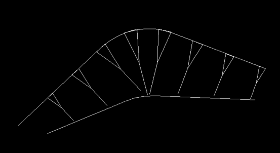

BIGAL Posted March 1, 2024 Posted March 1, 2024 (edited) A may be method, is (Entsel pick arc1, (entsel pick arc2. Then explode both plines this means they are now arcs, then use ssget pt1, ssget pt2 to get the arcs, the points are (cadr of entsel, work out the points along the arc based on number of batter lines, do for both arcs, then do a UNDO, the plines will be restored but you have all the points still. A Undo does not undo Lisp values. No need for complicated getPointAtParamas. Simply tested up to work out points, but no code. Should do complicated shape like image by LRM. If worth looking into more ask. Just further comment I use a tadpole block and just scale to fit between top and bottom. Just pick 2 plines. Edited March 1, 2024 by BIGAL Quote

BIGAL Posted March 28, 2024 Posted March 28, 2024 Try this. batterticks.lspFetching info... tick.dwgFetching info... Quote
