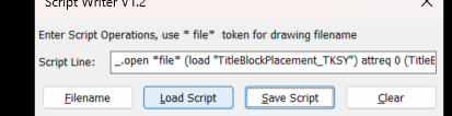

@rlx I tried to use Lee Mac's script writer, but it is not for long script as like me. it allows only one line. I might be using it wrong. I read Lee mac's article for that script writer, and it is saying it is for instant script generator for 2 to 3 command. If you have any clue how to upload and run my .lsp into it please let me know. Thanks for your input and taking my request in consideration.
Edited by amol1234

I've never worked with Lee's scriptwriter myself but I assume you only need on line , the name of the script and in that (.scr) file you input your commands.
Just start notepad , write line 1 : (load "TitleBlockPlacement_TKSY") , line 2 (TitleBlockPlacement_TKSY) , line 3 : .qsave and then save the file as TitleBlockPlacement.scr
You said a 1000 dwg's well don't do that many in one go in case somethings srews up, always make a back up copy 1st. You can put a lot on a USB these days.
I've never worked with Lee's scriptwriter myself also. But had a go and got it to work. But did not test, do that on say 10 dwg's in a test directory. be careful and check the script I did not have a space between .close and the file naem but fixed with a replace. Just another suggestion use (setvar 'attreq 0)
I just cut and pasted the rlx code 1 line at a time.
Ok you get like this 1st line I had 67 lines.
_.open "D:\Acadtemp\3D Model.dwg" (load "TitleBlockPlacement_TKSY") (setvar 'attreq 0) (TitleBlockPlacement_TKSY) .qsave "D:\Acadtemp\3D Model.dwg"

@BIGAL Thanks for trying this out for me. Does this thing worked for you? I have tried on myend but its not giving me desired output.Instead it gives me this selection which is attached with this post
_.open *file*(load "TitleBlockPlacement_TKSY") attreq 0 (TitleBlockPlacement_TKSY) _.save  *file* _.close (I tried this line in that script writer)

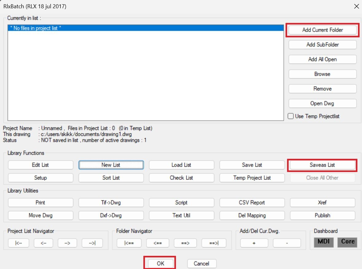

  1 - Open notepad and make script file (whatever.scr) containing load your routine , attreq bladiebla....and qsave at the end.
  2 - Open one of the drawings you want to process
       (or 'AddSubfolder' after RlxBatch is started)
  3 - Load RlxBatch (this app is part of my startup / autoload)
  4 - Start with command Rlxbatch
  5 - click 'add current folder'
  6 - click 'Saveas List' and give it name
  7 - click OK to close app (that way list is loaded next time because you could also click cancel )
  8 - close drawing (all drawings in list must be closed)
  9 - start new drawing
10 - load & start RlxBatch again
11 - click on 'Script' , select script you just created and lean back
I assume you at least know how to make a script file.
This app doesn't save drawings by itself so you must add save command in your script.
And , sorry, no , still haven't written a manual but I hope app is intuitive enough. It's not my latest version but that version is so over the top (over 500kb) and probably half of it I don't remember any more how it works or ever having written it (lot of code was written on the fly / in the heat of the moment so a lot of dead code probably)
app can handle both MDI and SDI & accoreconsole also (see Setup , but I can't use that option myself anymore on my work laptop because all bat files are blocked)
I hope app (still) works and it helps
ps. you don't have to add open or close in your script , appie will do that for you.
If somethings is unclear or not working let me know and if it is working that also would be nice to know.

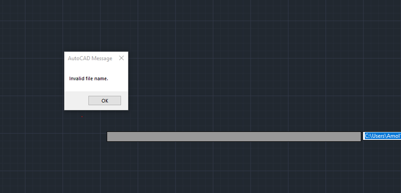

@rlx sorry for late reply. I tried your suggestion. Its loading files but after running script. First this error occurred

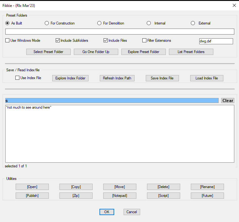

yeah , was afraid not everthing was working after all these years. Also some buttons are not generic but designed specifically for my own work environment. You could start app and click on button [edit list] to see if all files are in list or button [Check List]  to see which files are missing. It may have something to do with (mapped) network drives. I believe in [Setup] there's an option for that , not sure , would have to test this version my self.
I'm still working on & off on other app in the spare free moments I have right now (big six week turn around at this moment at the plant I'm working) but that app is still unfinished. I think the script part is working. I'll add it on a as-it-is basis with absolutely no time for support at this time. Too much pressure right now to get things finished.
Publish part is not working yet and [Future] button also isn't working. That should enable me to press button and five seconds later work is done but I'm still thinking about how to write a Tardis sub-routine for that 🙂
Also no manual for that one. It's meant as an evolution of DIP , my dynamic input routine.
Index part is also not implemented yet.
but you're free to try this still experimental version.
Fikkie2024.lsp
@rlx I tried to run fikkie but after putting script I am getting these error:
Command: FIKKIE
there were no naughty files
No commands found in slave script : C:\Users\Amol1203\Documents\lisp\Fikkie-ScriptFolder\script.scr
Done.
There might be chance that I am not able to make script of lisp program. Cause I just put down my lisp program into notepad file and saved it as .scr
Edited by amol1234
just tried it and script works for me. Fikkie tests if there are any commands in script file. If test returns an empty list it displays this error.
You could try to start script dialog , put in a name and click on create , enter some commands and don't forget to save the script file (as scr) , maybe your scriptfile is saved as txt?
Will add edit botton for scriptfile later.
@rlx Thanks for support but still it is not working for all files. It just doing its work for one file and close my file.

After that gave this error:
AutoCAD menu utilities loaded.
Command:
Command:
Command:
Command: (load"RlxBatch")
; error: LOAD failed: "RlxBatch"
Command: (RlxBatch_CloseAllButCurrent)
; error: no function definition: RLXBATCH_CLOSEALLBUTCURRENT
Command: .open
Command:
you should place fikkie of RlxBatch in one of your support path's.
If you type (findfile "RlxBatch.lsp") or (findfile "Fikkie2024.lsp") and this returns nil instead of a path, routines are in a bad place.
If your own script or lisp routine contains an error , this also will stopt any script.
