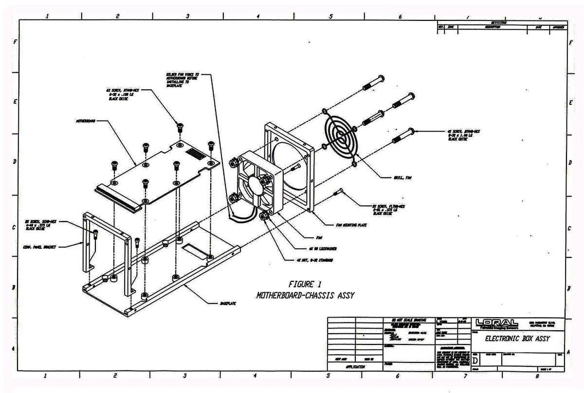

Without knowing all the details of what you're working on, perhaps your tutor is actually looking for an Assembly drawing, like the one shown below? It would be best to ask for clarification on what exactly they are looking for.

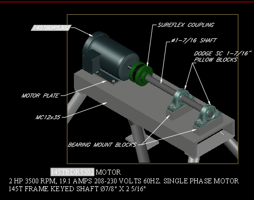

Pretty much a GA (General Assembly) drawing is just what you stated, a view of the assembly all put together, sometimes with (as the actual bicycles in your case) other items that would go along with the assembly, but not part of it, in some cases people using it, a dog in a dog cage, etc.
Mine is usually a 3D type view (sometimes more than 1) and sometimes with some of the parts/pieces labeled.
Maybe this article will help.
General Arrangement Drawings 101: Understanding the Importance of GA Drawings
Here is one I have done for a coupling test support frame, it shows how the components are assembled on the support frame.
