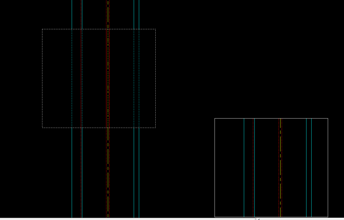

hello:
I found this on the internet, but I would like to know if there is any version
which allows not to alter the original drawing and only make a cutout of a specific area to place it somewhere else.
example:
box selection
here code
