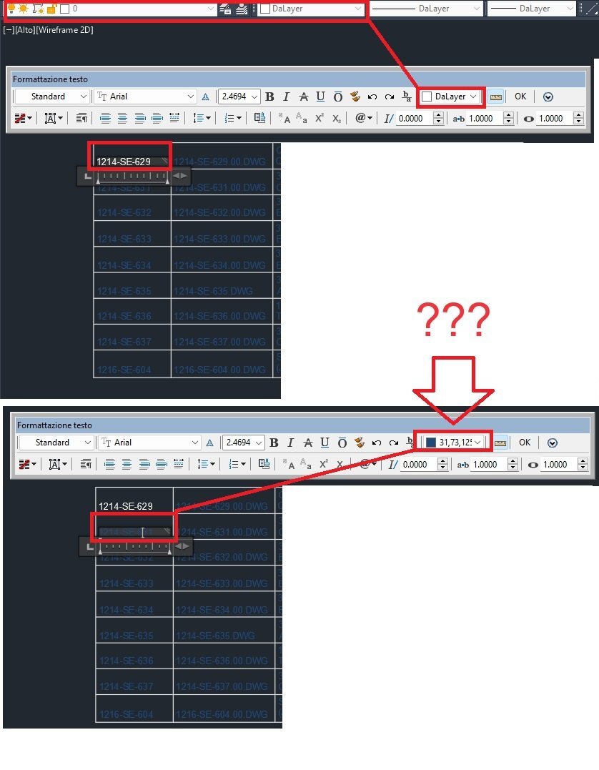

Hi, multiline texts have a double possibility of color management which I have never understood well and which I describe below.
Inside the multiline text formatting bar, there is a special cell that manages the color.
If this cell is differently from "dalayer", I cannot change the color of the text without opening the formatting bar (for example changing the layer to which the multiline text belongs).
Is it possible to "reset" the selected multiline texts, setting them as "dalayer" without opening the formatting window for each one?
The "match properties" command also fails to change this setting if you use it from text set internally as "dalayer" to text with "forced" color.
Greetings and thanks

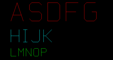

There is another post maybe yours about making mtext with multiple text lines, with different colors and text size, as suggested, remove formatting and start again. Look for the other post. It is only a couple of days old.
Edited by BIGAL
Hi, I had created a topic in the past that led to the same solution (use of the same lisp) but it concerned another problem
Are you referring to this? do you want me to do something?
No it was like a week at the most. This is string for image. Can set text font also.
"{\\C1;\\H2.42915x;ASDFG}\\P{\\C4;\\H1.619433x;HIJK}\\P\\C3;LMNOP"
