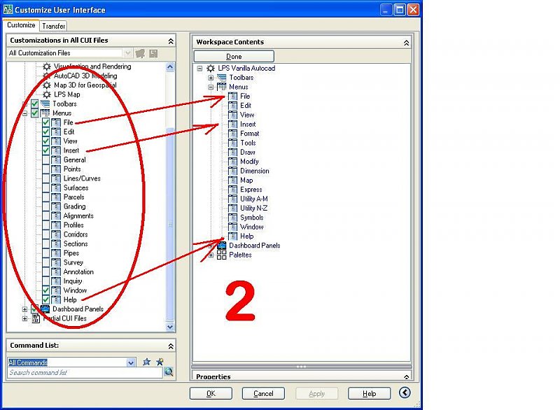

I have been trying to edit the menu shown to add "Format" menu but after reloading some files I got two of "File" menu instead. Any help will be greatly appreciated. Thanks.

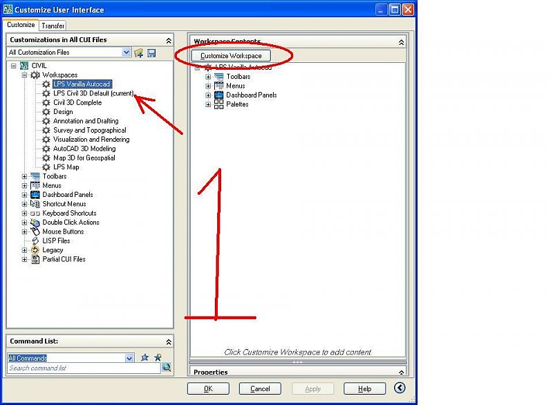

In CUI, select your Workspace (Left pane) > Customize Workspace (Rt Pane) > Expand Menus in both Left and Right panes. On the left check or uncheck the menus you want (you may need to expand the Partial CUI Files (ACAD) to get Format. On the right pane are the Menus you'll have; the can be rearranged there. I think you can have only 24 (25?) show on startup.

1. In CUI, select your Workspace (Left pane) then click Customize Workspace (Rt Pane)
2. Expand Menus in both Left and Right panes. On the left check or uncheck the menus you want.
3. You may need to expand the Partial CUI Files (ACAD) to get to the Format menu.
