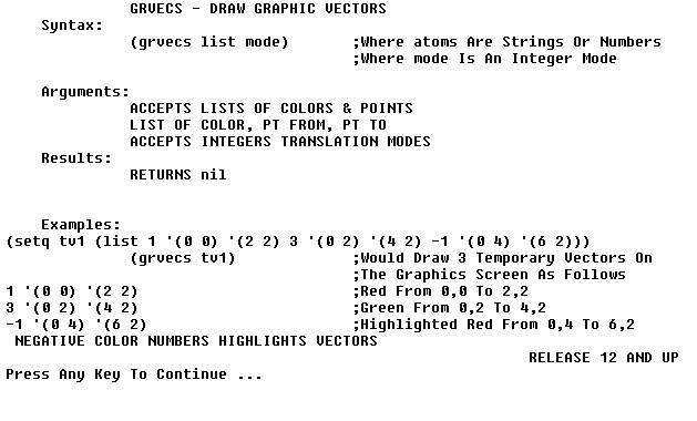

David Bethel Posted March 2, 2009 Posted March 2, 2009 I would have thought that you would be looking more towards a circle in lieu of a box. maybe (grvecs) would help. [b][color=BLACK]([/color][/b]initget 1[b][color=BLACK])[/color][/b] [b][color=BLACK]([/color][/b]setq c [b][color=FUCHSIA]([/color][/b]getpoint [color=#2f4f4f]"\nCenter Point: "[/color][b][color=FUCHSIA])[/color][/b][b][color=BLACK])[/color][/b] [color=#8b4513]; r=radius[/color] [color=#8b4513]; a=start_angle[/color] [color=#8b4513]; s=segments/2[/color] [color=#8b4513]; i=increase_angle[/color] [color=#8b4513]; pl=point_list[/color] [b][color=BLACK]([/color][/b]setq r 20 a 0 s 16 i [b][color=FUCHSIA]([/color][/b]/ pi s[b][color=FUCHSIA])[/color][/b] pl nil[b][color=BLACK])[/color][/b] [b][color=BLACK]([/color][/b]repeat [b][color=FUCHSIA]([/color][/b]* s 2[b][color=FUCHSIA])[/color][/b] [b][color=FUCHSIA]([/color][/b]setq pl [b][color=NAVY]([/color][/b]cons [b][color=MAROON]([/color][/b]polar c [b][color=GREEN]([/color][/b]+ a i[b][color=GREEN])[/color][/b] r[b][color=MAROON])[/color][/b] pl[b][color=NAVY])[/color][/b] pl [b][color=NAVY]([/color][/b]cons [b][color=MAROON]([/color][/b]polar c a r[b][color=MAROON])[/color][/b] pl[b][color=NAVY])[/color][/b] pl [b][color=NAVY]([/color][/b]cons 1 pl[b][color=NAVY])[/color][/b] a [b][color=NAVY]([/color][/b]+ a i[b][color=NAVY])[/color][/b][b][color=FUCHSIA])[/color][/b][b][color=BLACK])[/color][/b] [b][color=BLACK]([/color][/b]grvecs pl[b][color=BLACK])[/color][/b] -David Quote
Lee Mac Posted March 2, 2009 Posted March 2, 2009 I wish I knew more about the grvecs function - that and the grread and grdraw are always a mystery to me. And the ACAD help on grvecs isn't too helpful either.. Quote
David Bethel Posted March 2, 2009 Posted March 2, 2009 Lee, GRVECS and GRDRAW are pretty simple. Different input style, same basic output ( temporary lines displayed on the screen ) GRREAD is a totally different animal and has always had a bad rep as far as consistancy. I've never used the translation mode matrix with grvecs. -David Quote
Lee Mac Posted March 2, 2009 Posted March 2, 2009 Oh I see, so you are effectively creating the list in reverse, hence the last (cons 1 pl) sets the colour. And a suppose you are creating a list of points around the circle between which lines will be drawn. Thanks David, I understand it a little better now Cheers Lee Quote
