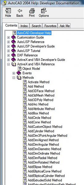

But where can I get help for vla-* functions. I know I ken get list of them using VLisp's Apropose, but there is no help provided with this list...
It isn't AutoLISP functions but properties and methods of ActiveX objects. You can find it in ActiveX and VBA reference inside Developer Help. There syntax VBA is used, however to use them in syntax AutoLISP not difficult.

Some help is provided for these Methods and Properties, see here (you can find properties list underneath it).
