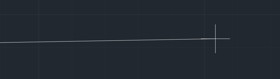

i was doing some stuff and all of a sudden all of my drawings lost their capability of making straight lines on its own .
i did not change any settings from what i recall but i havent been using any other settings for snap lines , only the one you normally get when you install the product

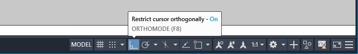

The F8 key on your keyboard toggles orthogonal locking On and Off. Orthogonal locking restricts cursor movement to horizontal and vertical only, for drawing straight lines. You can also click the little button at the bottom of your screen, as shown in the image below.
