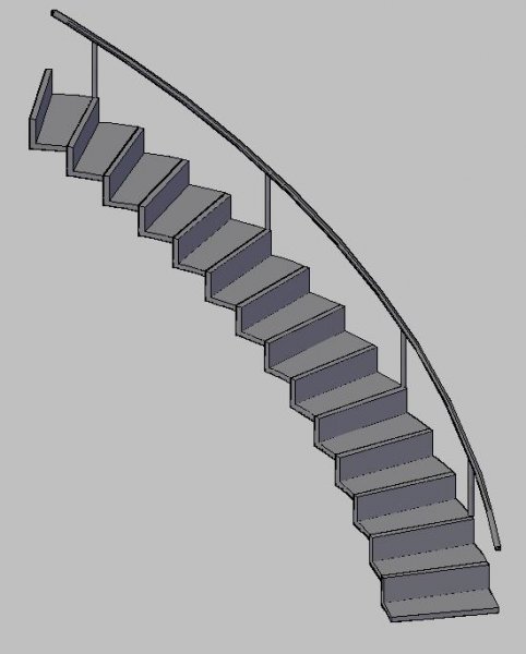

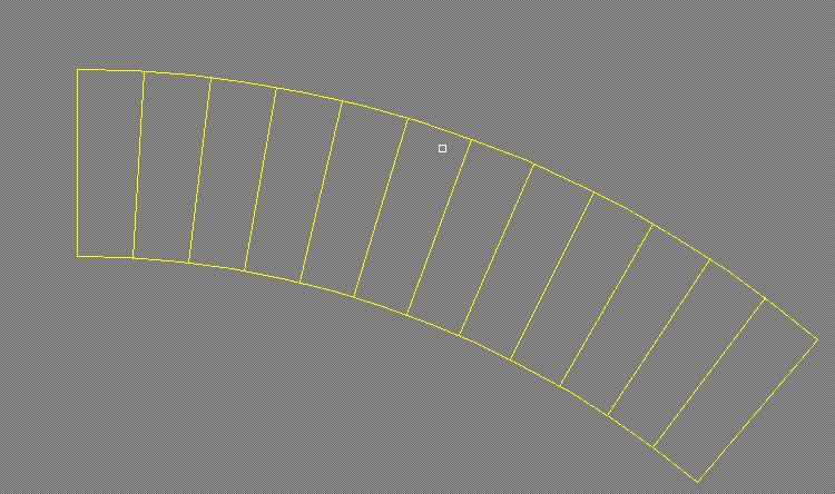

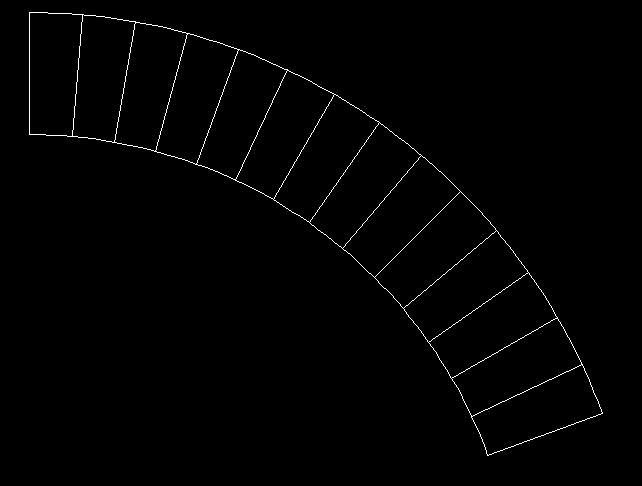

I made this curved stair model. I'm fairly new to the 3d, but I thought I'd toss this in here in case it helps someone.
Step 1: plan view

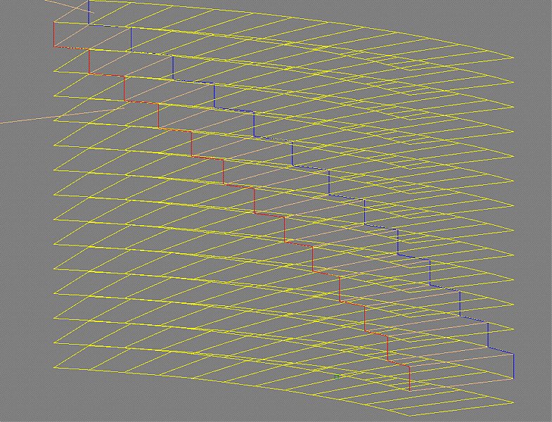

Step 2: copied the plan view multiple times x riser height. 3DPOLYLINE the treads and risers each side (red and blue). Then connected each side with LOFT

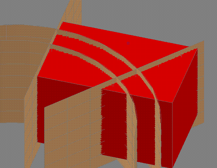

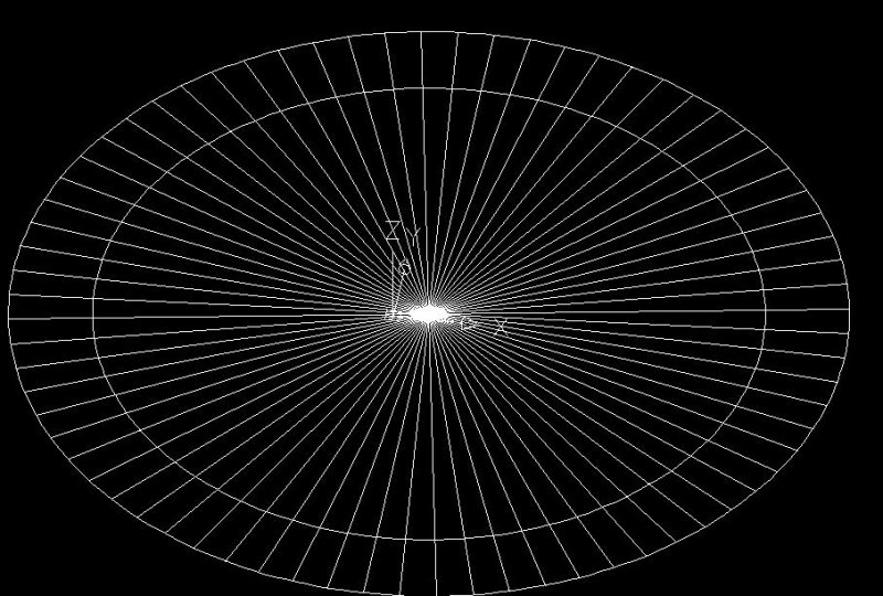

Step 3: slicing planes by extruding lines from plan view.

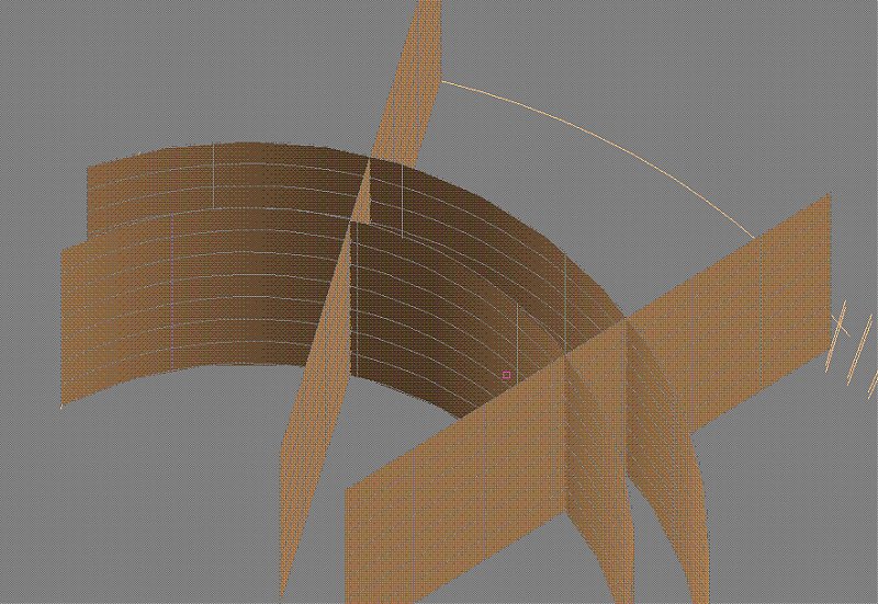

Step 4: sliced a box with surface planes.

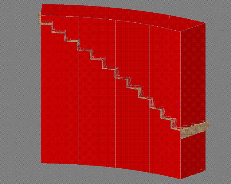

Step 5: sliced the new box with the lofted stairs. I originally had a problem slicing. Remember to make the slicing plane slice completely through the solid.

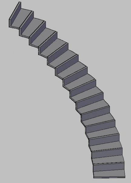

Step 6: end product.
Step 1: plan view

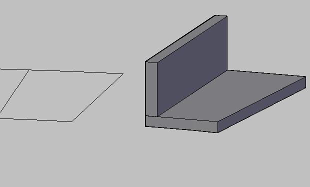

I saw this thread and the method the method used by qball to create the stair, so I thought to give it a try in another way :)
Here what I did:
First I created two circles and arrayed lines, just to find the good shape of the curved stair.
Then I trimmed extra lines,
Then I took one step only, made a region, extruded the step and made a "wall" to the step, so that I have one solid step.
After that I arrayed the steps in similar pattern as the stairs in the first image.
The steps now are in the right place, but they are in flat plane, so I moved up the single stairs one by one.

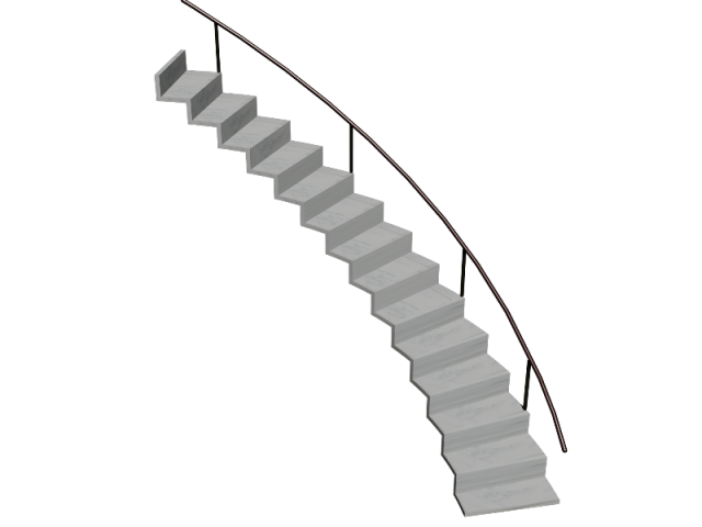

The stairs are now ready, Using spline tool I made the hand rail, because it is very difficult (at leat for me!) to make it with simple arc.
And here is the final render, after adding some material and lights
