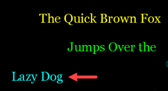

Hi all, how do I modified Lee Mac's Align Text so that the Bottom Text is stationary?
For example, "Lazy Dog" stays at the same location, while "Jumps Over the" and "The Quick Brown Fox" will move on top of it?
https://www.lee-mac.com/aligntext.html

I've tried swapping 10 11 to 11 10 but that didn't work

Change:
(vl-sort-i ins '>)
to:
(vl-sort-i ins '<)
And the two instances of:
(- bp2 spf)
to:
(+ bp2 spf)
You are Legend, Lee Mac! It is perfect. Thank you.
