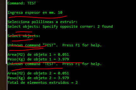

hello all people:
I have this routine I am interested in extruding closed polylines
and thus convert them to solids ,
I am interested in printing the area of each polyline and obtaining the weight of the solids created.
I just need to put a filter so that it only selects closed polylines
Also in each iteration this appears and I would like to remove it and have the information displayed together
here I put my code

any comment is welcomed
It's better?

It improved a lot, could you make it also select circles?
thanks already added this
(setq sel (ssget '((-4 . "<OR") (-4 . "<AND") (0 . "LWPOLYLINE") (70 . 1) (-4 . "AND>")
        (-4 . "<AND") (0 . "CIRCLE") (-4 . "AND>")
        (-4 . "OR>")
If you make a solid then using ( vlax-get (vlax-ename->vla-object  (entlast)) 'Volume) will return the volume, note in your calcs to maintain accuracy a good idea is use reals 7850.0. You  can end up with integer answers and not realise it.
