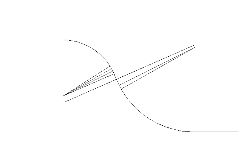

I want to convert many straight lines into one arc.
Try this one, I think it is a bit more reliable... but might not be.. in testing with your sample it was working - for me.
Command: L2Arc
Select all entities and it should locate arcs and convert lines to arcs. Arc is defined if 3 or more adjacent lines have a similar perpendicular intersection and are a similar line length

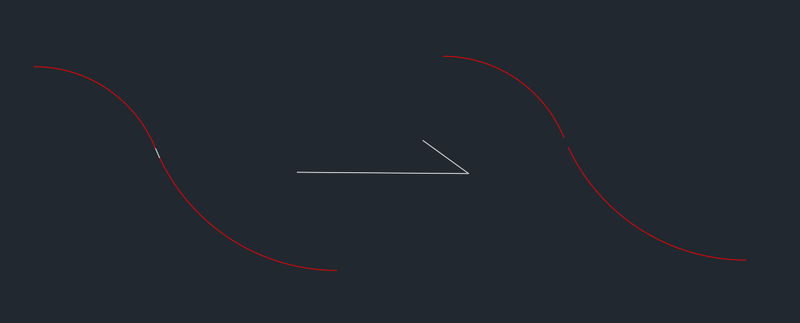

OK I think for me this is just to adjust the limits of what it thinks are part of the same arc
Edited by Steven P
OK, here is one more try at this.
Make a selection of all the lines you want whether they form a part of an arc or not. It -should- loop through it all and convert any it considers to be arcs into arcs.
The calculation works matching the origin of a circle on formed on points of adjacent lines. If the origins are out by too much then they won't make an arc.
Adjacent lines are found from an area round the end of the last one, however if there are very short lines this currently makes an error, and similarly a small gap between adjacent lines also has an error (I think I know the fix for these),
But in a nice drawing this works well. In the example drawings above some of the more complex shapes have very short lines (like almost zero length) and very small gaps - I've put a small function in there to choose an adjacent line which fixes a couple of these but if not it zooms to the problem area - you'll see what I mean.
Works better than what I had before

I would like to express my gratitude first.
I used Lisp you made for 3 days.
It definitely works better than the previous one.
Is it possible that the problem areas you mentioned cannot be improved?
'Adjacent lines are found from an area round the end of the last one, however if there are very short lines this currently makes an error, and similarly a small gap between adjacent lines also has an error (I think I know the fix for these '
We also found that the hole became larger with some use.
I also found areas where the lines overlap.
We also discovered areas where Lisp was not applicable.
We also found cases where the results were different when the shape was the same but scaled differently.
Thank you to everyone who helps us every time.
NG sample 24.03.04.dxf
Interesting and thanks, this is one I am going to keep for myself so worth me taking the time over it, I should have time this week to look at the very small lines and small gaps.
Having a quick look, some of the circles are not -quite- identical (overlaid one on top of another, overkill, and there are some lines left from both) which might explain that.
  • Like 2
I too deal with a lot of files each day where the radii are broken into many small straight lines.
I think one of my clients creates the Rads in their Cad environment using splines, and then converts them into polylines which makes them change to these small line segments.
Please keep up the great work Steven P, this appears to have been progressing nicely, and I can't wit to see the final result
