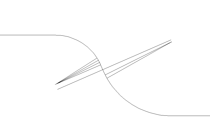

I want to convert many straight lines into one arc.

  On 2/17/2024 at 11:07 PM, BIGAL said:
Maybe just look at lines that are short and look at next point a none short would be start of a line to be kept. Then work out the radius. Will think about it.
Expand
That's what I reckoned, make a selection set from touching lines of similar length (I reckon the end segment could be shorter than the others if the arc is made from even length segments, with one shorter end one to make up the rest)
A better idea is to work out by calculating the perpendicular bisectors of the line segments. Take 3 consecutive lines and calculate the point where the perpendicular bisector intersects. The point where the perpendicular bisectors meet is the centre of the arc, so if they are within close proximity (to a certain tolerance), then this entails an arc segment. Otherwise, it's not.
Edited by Jonathan Handojo
  • Like 2
I think this is the next step, it isn't pretty though but I need to go to the supermarket.
Select 1 segment in the arc. Might fail if the arc doesn't have a straight line either side of it and a few other errors. not tested fully and needs be tidied up with some notes added.
Try it and see.
Step after this is to do this for all the drawing and not one arc at a time

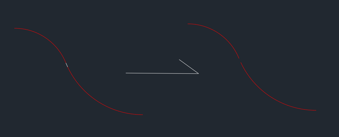

This took a bit longer than I hoped - but an interesting puzzle (though of course, it is obvious what to do now)
It should find lines that connect together to make an arc. If 3 or more lines have a perpendicular line that intersect at nearly the same point this assumes they are straight segments to form an arc. Straight lines are deleted, arc takes their place.
Command: foo
--EDIT-- will get up set if 2 consecutive lines are colinear.. I'll think about that

A question for Bear, is the shape always ortho line work ie 0 90 180 270 with arcs. May be a real quick solution.
First of all, I would like to say thank you to those who really help me.
In this section, the Lisp I am currently using also does not work correctly.
In the case of that section, I am working on it after deleting one short line in the middle. (Delete the short straight lines between arcs)
After work, the work of reconnecting it into a straight line is done manually.
I'm sorry for not being able to tell you about this issue in advance.
Once again, we would like to express our gratitude to those who are helping us.
In your sample drawing the lines in this area are 2 arcs, the short joining line is a continuation of arc, see below. Drawing a line perpendicular to the segments and from their mid points, if end 'B' intersects with the others then this forms the arc. My LISP above draws it like this - 2 arcs, no short line
If the short line is extended for example then the perpendicular line doesn't intersect at (nearly) the same point as the others, it isn't a part of the arc and so is by-passed in arc creation. Not sure how to program that if there are 2 consecutive arcs and which line to use as the joining line
So in the case of the arcs joining you might need to manually remove the line, create arcs and add it back in again? Or do a combination of the earlier LISPs for joined arcs and the one above for all the rest?

I will share with you the types of problems that occurred during my testing.
First of all, it was impossible to change all the lines to arcs at once.
Sometimes it works if you do it one by one, and sometimes it doesn't.
I am grateful for the progress made so far, but it would be great if I could get help with the problematic areas as well.
NG sample.dxfFetching info...
I noticed that yesterday but didn't have time to look into what wasn't working quite right - one of those frustrating intermittent things I think - I'll see if I can get chance to look again and see what I did wrong. Nearly there though for what I want it to be
The wow works with your latest dwg, ok for the dbl reverse curves select not quite a full 90 degree of lines for both arcs, then draw a line using osnap Center then extend the arcs to that line, you want to zoom in where the 2 arcs join I did find a tiny error so moved 1 arc end point. The other thing I noticed is for the dbl in some cases where the 2 radius where maybe meant to be the same I get a slight variation in the 2 arc radius.
